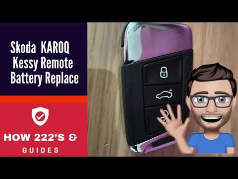

        The Keyfob you mention as "new", has been around since the B8 Passat was released in 2015.
        So both my Alltrack and Superb have exactly the same keyfobs.
        There is a new key though, the MK8 for example has the very new style keyfobs; Key fob battery replacement VW Golf 8, Leon KL, Skoda Octavia NX e Audi A3 8Y 2020/21 Tutorial - YouTube

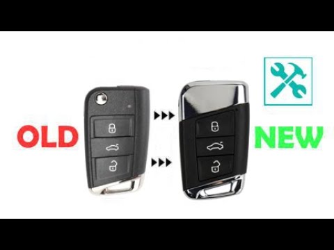

                If I was going to buy something from Aliexpress, for a few dollars more I may buy this
                MQB Car Modified Replacement Remote Key Shell Key Case for VW Golf MK7 Jetta Tiguan Polo for Superb Octavia Yeti Fabia for SEAT|Key Shell| - AliExpress
                Watching the video looks like it takes about 10 mins to switch the keyfob motherboard and key across

                            I got this same one from AliExpress a few months ago. Took a bit of prying to get the OEM key apart but not too bad.
                            In person the AliExpress shell looks quite cheap next to the OEM key. I ended up putting my OEM key back together as it just felt too low quality, even if it did save me from constant flipping out of the key.
                            I'm not sure what I did as the circuit board on the key seems 100% fine, but ever since I opened up the key the battery in it only lasts about a month max now. I pulled it back apart to make sure nothing was bent or cracked or touching but it's 100% fine.
                            I really wish they just used these keys on the Kessy/Keyless models as standard. There is no reason VW couldn't - they are all MQB keys.
