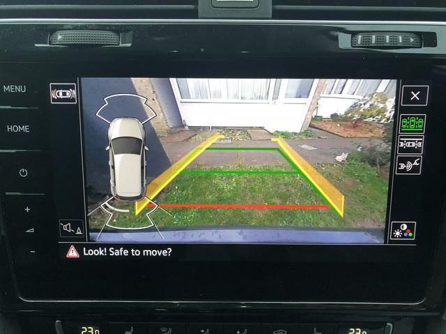

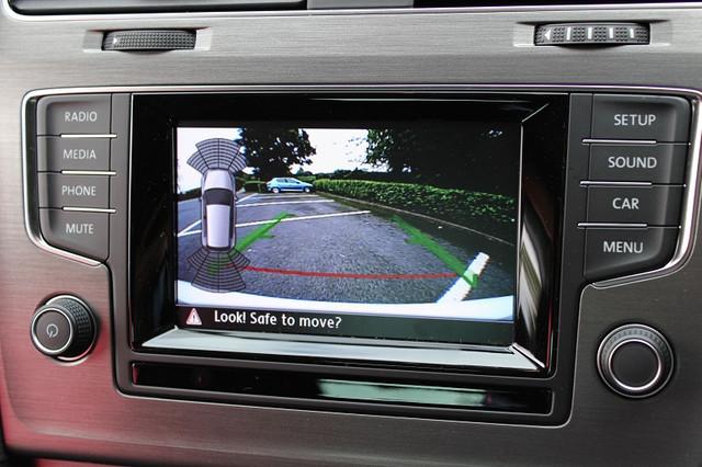

                            Highline reverse camera, as coding to get all the options is different from lowline with less options
                            Lowline
                            Highline (notice the buttons on right hand side to change camera angles/parking space)
                            Make sure 5F-long coding-byte19-bit4 is set to not active

                            i've sort it out using this way.
                            i think highline models and lowline models function is little different.
                            i found out that some how i manage to put my rear view camera function to lowline model so it did not show anything just black screen with out any guide lines or functions. so i have used above method and worked with me perfectly.
