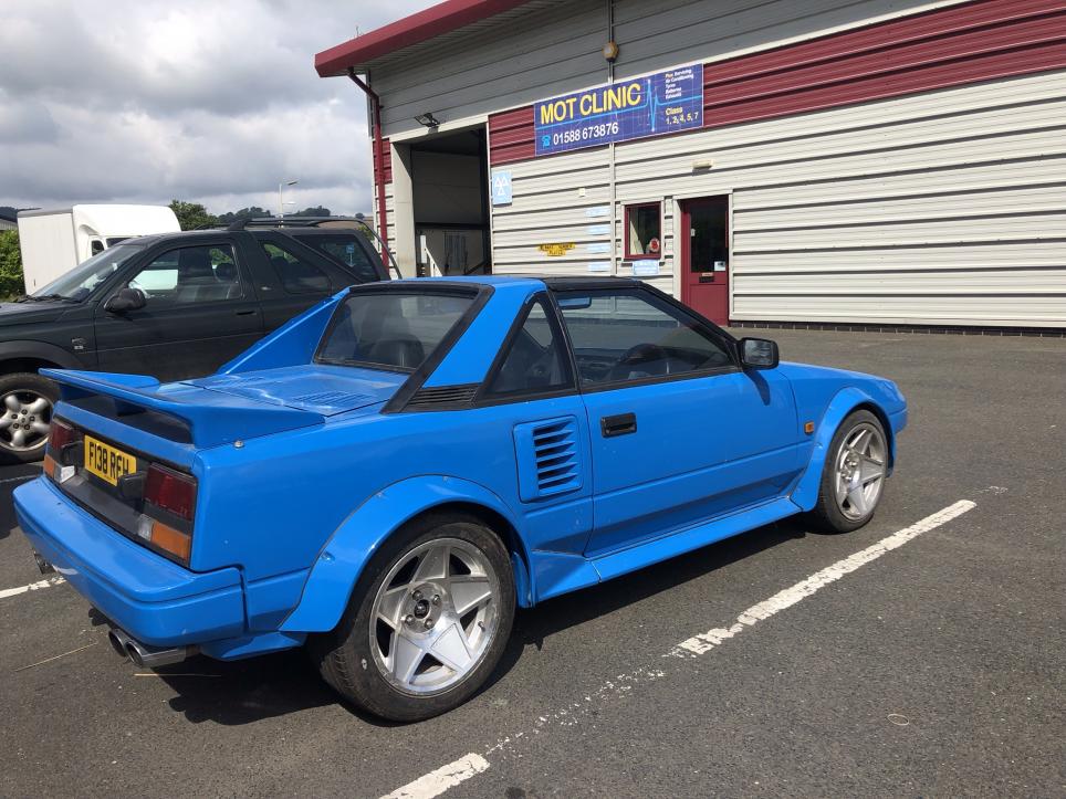

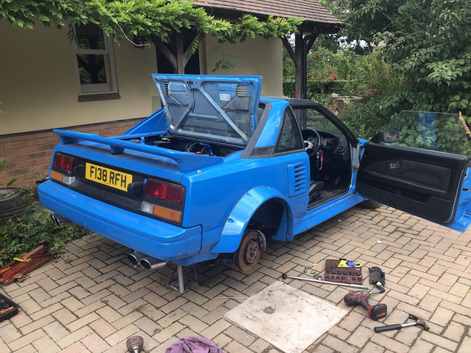

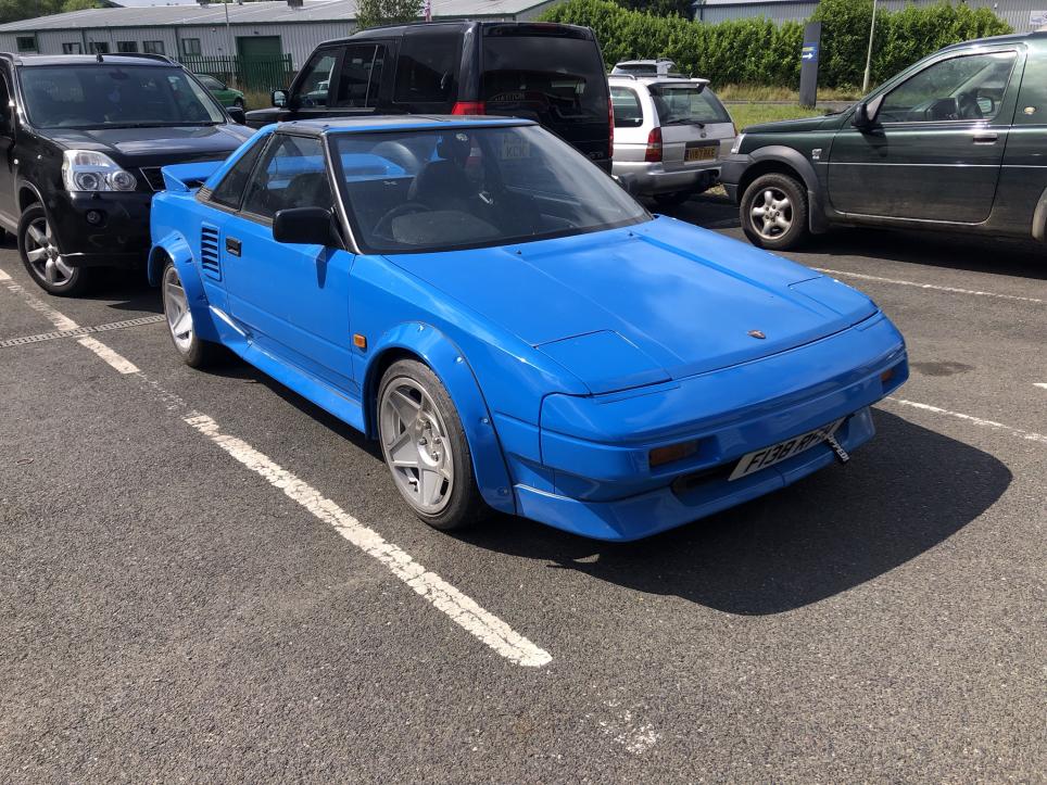

                  I'm not putting this in a Tiguan... or indeed a VW...
                  This is my 88' MR2, with a Civic Type R K20a2 engine.
                  I'm using a 2017 Golf R backbox, with the two valves, which I want to open when the engine hits VTEC as it needs more exhaust flow at that point.
                  The electronics on the car are early 2000 / 80's and it has no control system similar to CAN or LIN bus, so i need to make my own.
