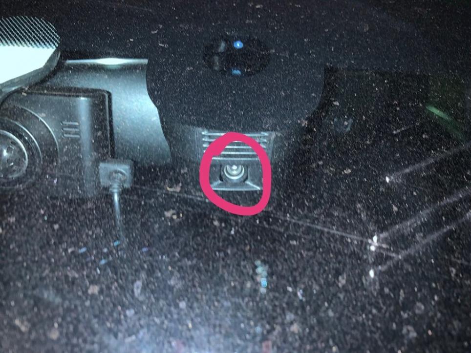

    When I asked the sales guy whether the Tiguans in SA have the forward facing camera, I was told it doesn’t! But then walking through a parking lot this evening I saw a Tiguan and thought I’d take a look. Now I know this is a camera, and I know it’s facing forward. But is this the multi function camera responsible for Lane assist, TJA, HBA and the like?

    Post a picture from a bit further back of the windscreen

      That looks like a low spec model.
      The camera is just for HBA (High Beam Assist).
      The correct camera will be located higher up on the windscreen (in a triangle cut out).

        I realise different cars in different countries have different spec, which is why I’m here. The salesman says they don’t do those features I mentioned. But then walking past I saw this camera — from what I have seen online, the multifunction camera seemed a bit beefier, more advanced! This did look a little small and insignificant.
        What I was hoping is that the Tiguans in SA may very well have the camera installed but just not programmed to be functional. I also understand this is also a waste of money for the manufacturer, but just covering all my bases before I commit.

          Thanks for the message. As I said above, I thought it looked a little small. But was just hoping I guess. That Tiguan I saw may have been an older model.
          Am I correct in saying that the multifunction camera sits higher up, looking more at a downward angle and the triangle cut out you are referring to is almost a “lighter colour plastic” look to it?

            It seems that all the Tiguans in SA don't and won't have the multifunction camera installed..
            Apparently even if the dealership put the order in from the factory in Germany, it will be denied..
            Only the Touareg has the multifunction camera and the DLA and all the features...
