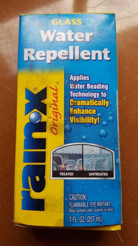

        Possibly a wax build up. Try Rainx windscreen treatment, it works well at removing residue and making glass silky smooth
          Have seen it said that stuff is fine if you DONT use wipers but goes all smeary if you do
          Mamba Ebike to replace Tiguan
            Not at all. On the contrary, it says you must still use your wipers. I've used it for years.
