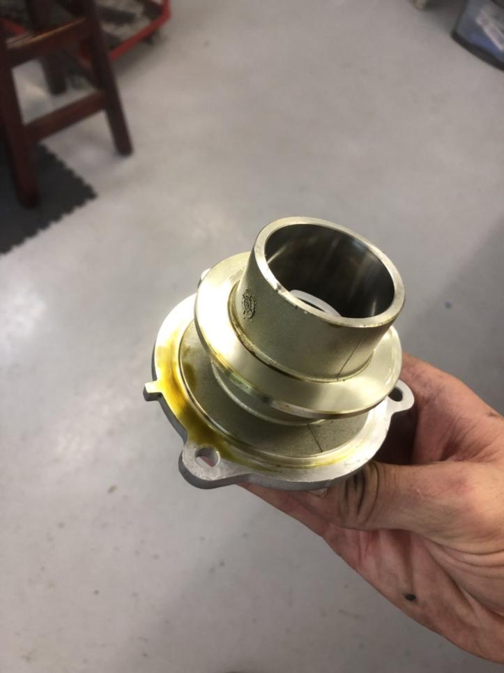

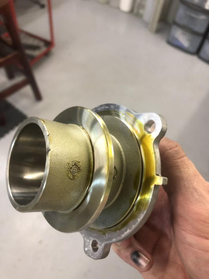

    I installed a muffler delete and intake elbow. I was horrified at the level of oil residue in the intake. Car has 3000km on it. And had an APR stage 1 tune.
    Oil on dip stick is around 3/4. I know my Evo used to push a lot of oil out if it was above half.
    Any ideas on how to stop this?

      Pretty normal that you get oil after the turbo.
      - Tigger73's 125TSI Build
        Thanks. But in that quantity? Seemed excessive for the age of the car.
          The visible amount won’t seem to change from not long after new - it’s constant ingestion. A teaspoon of oil looks like a lot.

                        You shouldn't see any oil on the turbo inlet. If you do then you have real problems as you're getting oil coming through the air intake/filter.
                        What we're talking about is on the other side of the turbo going to the intercooler. I'll have to check the stock pipework that came of when I changed over intercoolers. I think there was a smear of oil there but not massive amounts.
                          Any oil in the intake will always commence prior to the turbo (and quite often be visible on the turbo inlet) because the crankcase breather ventilates into the intake tract after the air filter, after the airflow sensor, but prior to the turbo. The crankcase gasses (which contain oil vapours) are dumped into the intake tract on the low pressure side of the turbo - so the gasses are vented into what is effectively a negative pressure area
