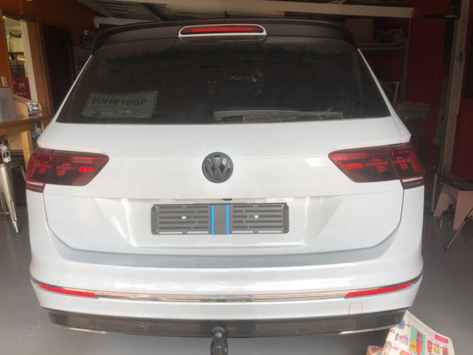

                Hey Gladbach, that might have been me! I made the costly mistake of just swapping the badge with a black Golf MK7.5 from EBay which I was told would work. It worked for a few days & than I started to get an ACC error intermittently which also stopped cruise control from working. Then the error remained on permanently. I had to take the car back to VW & they said that the ACC sensor behind the badge needed to be re-calibrated & the cause was due to the badge. $560 later!!! I have now found the correct badge from EBay in Germany & have been driving with it for over 1 month with no issues. The rear badge you can get the Golf MK7. I actually have a spare one if anyone is interested?
                Here is the link for the front badge: VW Zeichen Schwarz Vorne Tiguan 2 AD1 ACC foliert Emblem R-Line Allspace 4Motion | eBay
                I wouldn't recommend wrapping or messing with the OEM badge as it could potentially throw out the calibration of the sensor & cost you. They said that even a slight bump on the bumper is enough to throw out the calibration.
                I will try and upload some pics when I get a chance if you guys like.

                        Dig your blacked out Tig. Looking to do matte black rear emblem and was wondering where you picked yours up? I’ve seen where ones made for the MKVII Golf work, but seems dependent on the quality and if the clips line up. Also a fan of your R Line front emblem. I haven’t seen anything of the sort here in the States.
                        Thanks for any help on locating.
