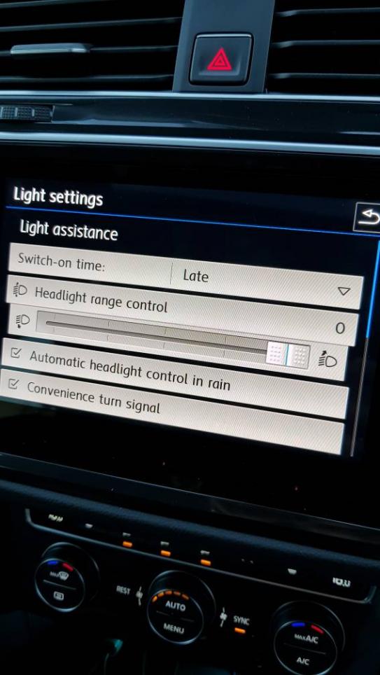

                      The Phillips version looks like it has a good chance of actually working and not blinding other drivers.
                        You can't blind the oncoming traffic as the base model halogen light unit has adjustable range control in it, even I set it to the highest position it is still ok. By the way I use J.W. speaker LED bulbs for low beam and I am very happy with it.
