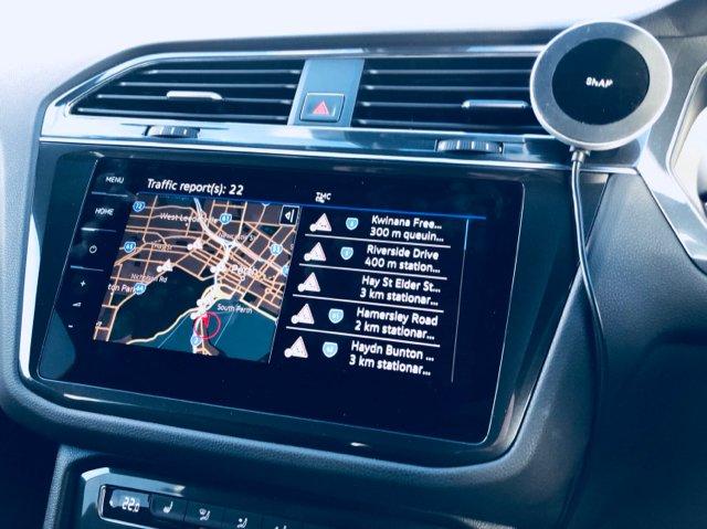

    I was able to successfully enable the following (not exhaustive list, just the ones that I have tried and it worked on my 2018 Allspace R-Line)
    - Disable Start / Stop (Voltage Method)
    - Lap Timer Activation
    - Driving school mode
    - Screen nag deactivation
    - Enable Traffic Information (TMC) on Headunit
    - Auto Close Windows When Raining
    The following didn't seem to work for me
    - Drivers Reaction Adjustment (Car must be fitted with Camera). I couldn't find the option listed in the instructions
    Instructions on how to actually tweak can found below.
    Mk2 Tiguan VCDS Tweaks
    Volkswagen MK7 Golf OBDeleven / VCDS Tweaks List – AutoInstruct
    Last edited by htran; 24-07-2018, 07:53 PM. Reason: TMC and auto close windows now working
    TMC is now working on my Allspace
