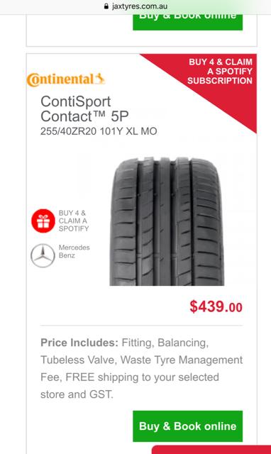

    I’ve had to replace a tyre (front left) quite urgently, and in my haste I didn’t make sure it was identical to stock. I was a bit over-enthused that I found a place, conveniently located, with one in stock that matched the main specs - 255/40/R20. I clearly explained to the shop (Bob Jane T-Marts) that I was after a replacement tyre for the new Tiguan R Line. I hadn’t realised the secondary specs differed.
    I’m wondering if someone can help me work out if there’s an issue with the replacement tyre differing from stock. I hadn’t realised it was different to stock until my tyre pressure light went off unexpectedly, a few days after the purchase.

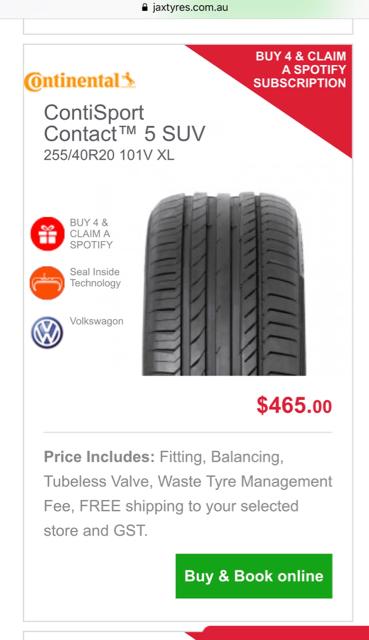

    These appear to be the stock tyres for my R Line tig - 255/40/R20 101V XL:
    This is the replacement tyre I got - 255/40/ZR20 101Y XL MO
    Im not an expert but the sizing is identical on both and the only thing different is the MO tyre is designed for the Mercedes brand but I am not sure if there is really a difference.

      The Mercedes tyre has a higher speed rating. V = 240km/hr and Y = 300 km/hr.
      There’s likely a small difference in the internal construction of the tyre and possibly the rubber compound that’s being used to meet the OE manufacturers spec (Merc vs. VW). The VW spec tyre also looks to have some internal “sealant” also (which clearly didn’t work in your case).

        Thanks both. Great help tigger. Would you in my shoes look to get a stock tyre re-fitted? That’s what I’m planning to do. I don’t like the idea of a different tyre with different properties on one wheel, though the differences are likely slight. I expect VW would say the same.

            I would be looking to get the original tyre fitted.
            These are two different tyres, being the Sport Contact 5, while the MO is a Sport Contact 5p.
            You can see obvious differences in the tread pattern, with more siping and smaller tread blocks on the VW tyre
            They are both optimised for different vehicles, the MO tyre is designed and manufactured for the Mercedes, all the driver assistance systems and braking systems are tuned to the properties of that tyre.
            The VW tyre has Contiseal inside, which will make a difference in rotating weight which could affect tyre rotation and give false warnings on the TPMS if a tyre without is fitted on the same axle as one with.

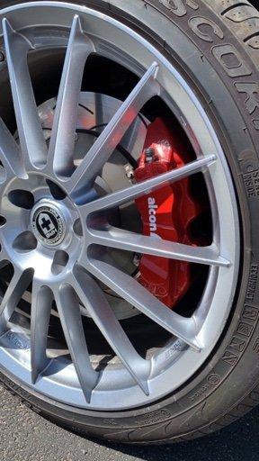

                          I swapped the Pirelli Scorpion Verde 235/45R20 onto my new rims (20x9) and they’re a bit stretched with zero rim protection. Next set will definitely be 255/40’s.

                            That's some good stretch happening there! Those brakes...
                            Sent from my SM-G955F using Tapatalk
                              Are they full calipers or covers and if so where can we buy them Please
