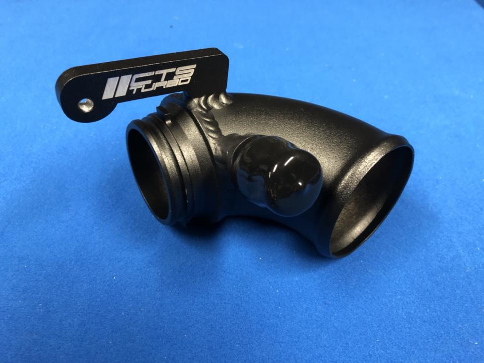

    CTS High Flow Turbo Inlet Pipe:

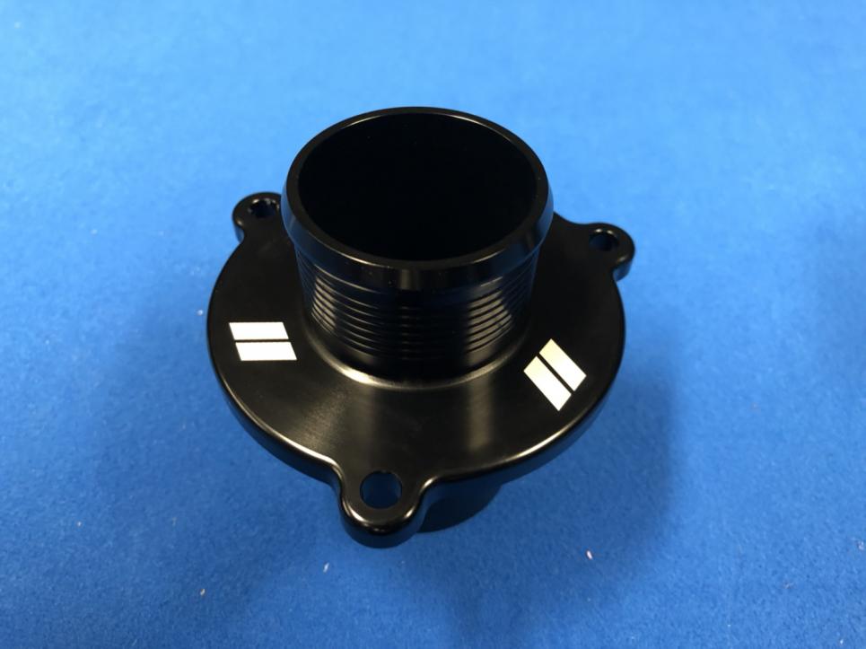

    CTS Turbo Muffler Delete:

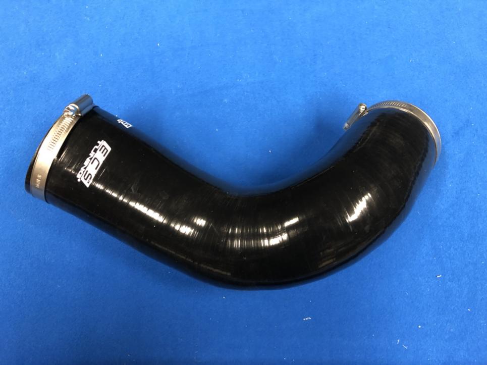

    ECS Silicone Turbo Inlet Hose:
    I have these on order from ECS Tuning which I should hopefully get in the next week. These were all cheap enough (especially since ECS were having a sale) and should be nice and straight forward for me to install myself. Once they turn up I will update the post with install details as well as how I find them.

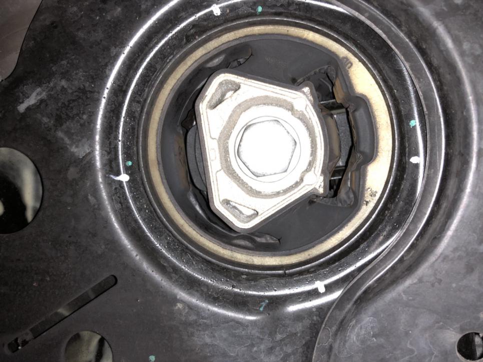

      Once the car was up I just slid under the front end and here is a shot of the factory mount:

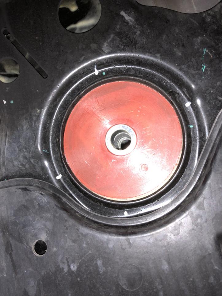

      Took a bit of brute force to get the factory bolt undone which was a little awkward as I didn’t have a lot of room under the car.

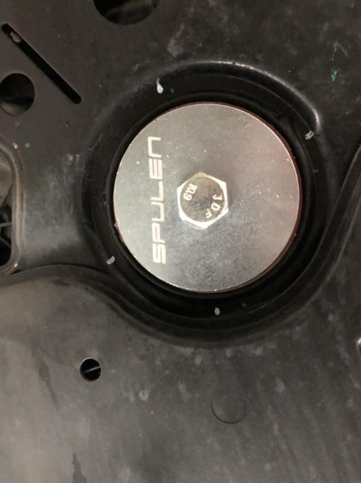

      Once the bolt was out the SPULEN Mount slipped in pretty easily. The skinnier front prongs seem to catch a little when trying to slide it in, I just had to give it a bit of a wobble while pushing to line it up correctly.
      My SPULEN came with a smaller washer as well as the large flat washer however all the instructions I saw online didn’t have this washer. At this stage I have left this off, I might email SPULEN to find out if this is needed and what difference it would make.
      Doing up the new bolt was obviously straightforward just a little awkward again tightening it up to the recommended 130Nm due to space.
      Here is what the new mount looks like installed:
      I took it for a quick test drive but couldn’t do too much as I had my son in the back. Definitely noticed some vibration when I first started the car but then that seemed to go away after a bit and then I didn’t notice much at all when idling.
      There is definitely a difference with the acceleration now, the lag seemed to be much less when in normal drive mode and seems much more responsive. When I put it in sports mode taking off from stationary was almost lethal, it was so quick to respond and much more like my old Golf R.
      There is definitely some vibration when driving but nothing too bad. What I found was it seems to resonate the engine vibrations so you actually get more engine noise inside which I kind of like. When I got the Tig I found it really quiet inside and struggled to hear the revs of the engine, I always drove my Golf R in manual mode with the paddles but struggled with the Tig as I couldn’t hear when to change.
      In reverse you definitely feel more vibration, which I read is common with these.

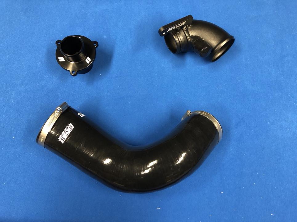

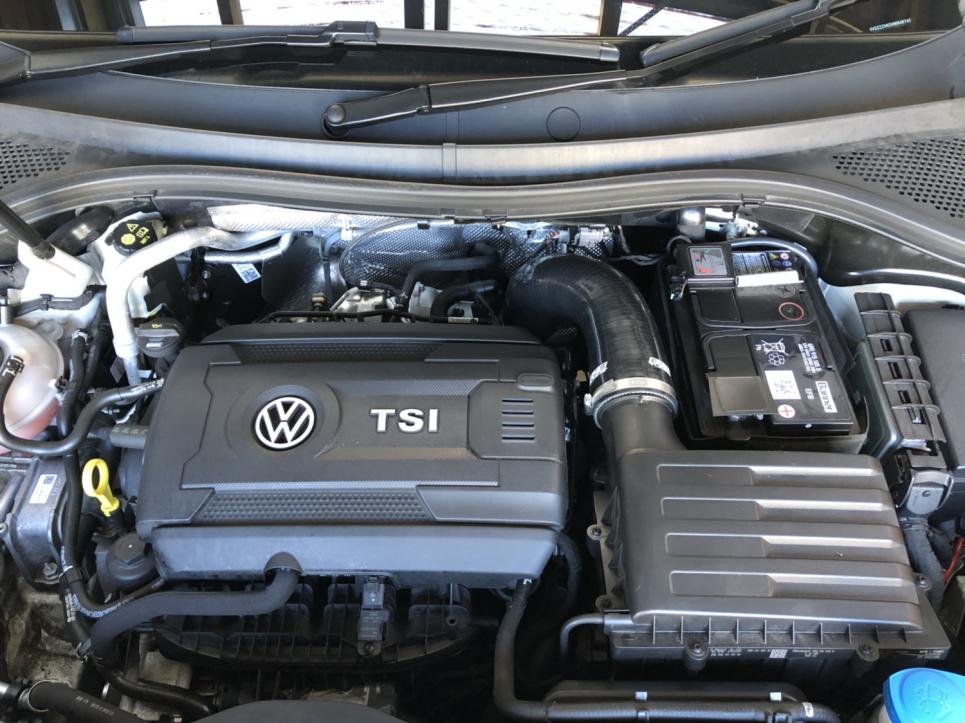

                      Look what turned up yesterday:
                      Me being impatient decided to install them all at 11:00 last night. Was generally pretty easy, will do a proper write up on it yesterday and well as my impression after I take the car for a drive today (was too late last night by the time I finished).

                              So have had a few days normal driving now with all these upgrades installed and have to say, overall I’m pretty happy.
                              Install was incredibly straightforward and really easy to do. I think it was all much easier to do than in the Golf (especially the Turbo Muffler Delete) as there is much more room in the engine bay. The only annoying thing is these are higher so spent most of my time up on my toes, over extending my knees leaning on the front bumper and front guard reaching everything (I’m 6ft so not short).
                              The install took me about an hour but I didn’t start until after 11pm at night so was doing it under my carport lights along with a torch and was fluffing around a fair bit. If I had waited and done it during the day would have been much quicker. Also, I forgot to swap the O ring over on the Turbo Inlet Pipe and didn’t realise until I was packing everything up so had to pull this off again to put it on.
                              The hardest part of all the install was taking off and re-installing the short silicone hose for the Turbo Muffler Delete. It was a bit fiddly especially trying to re-attach the hose but might have been easier if the light was better.
                              The ESC Inlet Hose fitted well and looks miles better than the factory plastic one. It was cheaper than the CTS one and I thought looked better in the gloss black, very similar to the Racingline one but half the price of that one.
                              I had already removed the snow guard a few days ago after reading about that (we don’t get much snow here in Auckland!!). Have to say with that and these upgrades I haven’t noticed much difference in the noise from the turbo, I still can’t hear much even with the windows down. I had been hesitant about doing a full intake with this as I found the one in my old Golf R, while sounded great, was sometimes a bit loud and annoying for a daily driver but now I am considering it especially if I can find one at the right price.
                              Apart from the lack of noise, I definitely find that with all the small changes has definitely made an improvement to the overall driving of the car. The throttle response is much better and I have a much better feel for the engine. I can now enjoy driving it in manual mode where I originally struggled without watching the rev counter all the time. Gear changes also seem a lot smoother as well in standard drive mode as well as manual and sport mode.
                              Everything except the Dogbone mount came from ECS in the US and I am really happy with their service. There was a bit of a delay in them getting one of the parts in from their supplier but once that turned up they shipped it on Saturday NZ Time and I received it Tuesday morning, our local couriers often can’t even deliver something within the country that quick!!
