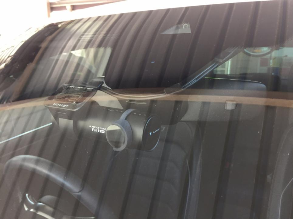

      First, from outside looking in. Notice the black double sided tape for the cable clips. Much better than the standard grey. The cable is routed to the passenger side as that's where the fuse box is on the Tiguan and it made for an easier install.

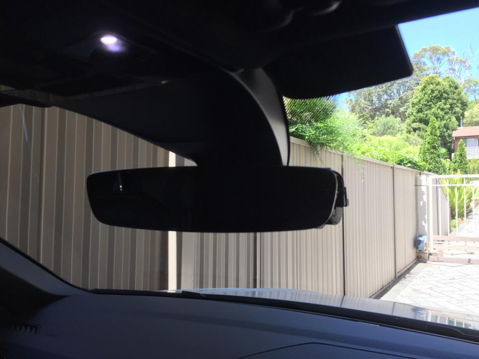

      Next is the view from the driver's seat. The camera is virtually hidden by the mirror. Make sure you check that you can still adjust the mirror to the desired setting for all expected drivers and seat positions. The black box above the camera at the top of the windscreen is the etag also cleverly painted black rather than the standard light grey.

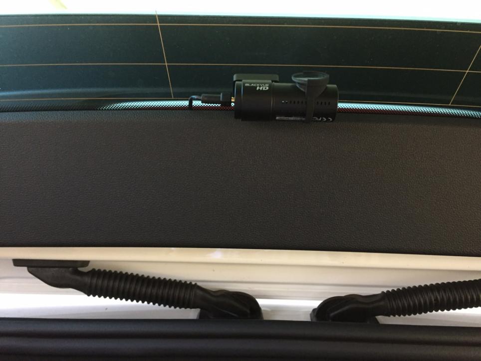

      Next is the rear camera. Photo taken with the boot open. Notice the cable is run behind the boot trim and then through the existing rubber conduit into the vehicle proper.

          How did you get through the rubber conduit in the rear?
          Did you have to take trim off?

            The Grommet at each end of the conduit just pull away from the bodywork, and then push back in. Used a bit of wire to pull the cable through to where the camera is mounted. It's pretty obvious once you pull out the conduit.
            I don't think I had to pull the trim off from memory, just fed it through with some stiff wire, coat hanger would do.
