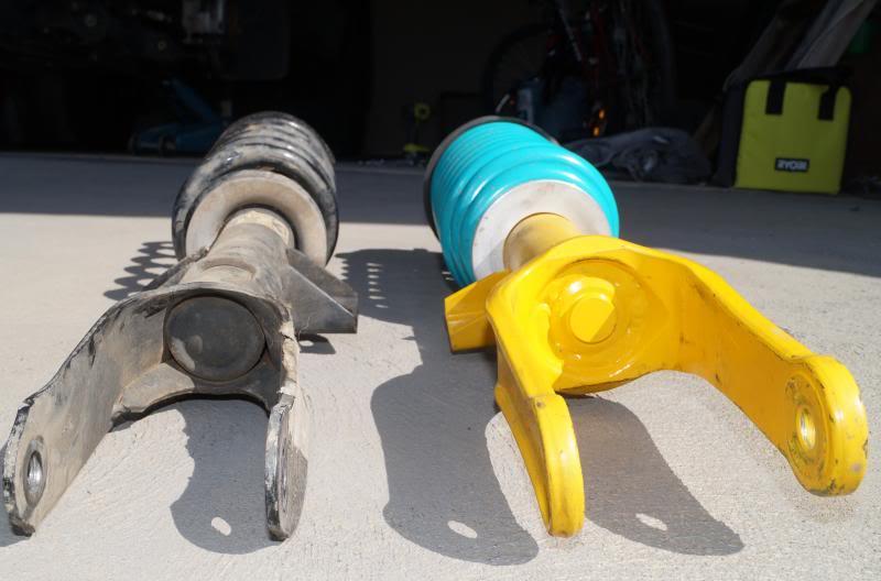

    FYI, a little info on the difference between the Bilstien and othr shocks.
    FYI, the difference between Bilstein B6 Off Roads and OEM (Seikel Dessert, OME, TJM, Pedders are simular to the OEM)
    Bilstein are made from nodular iron rather than pressed steel plate, the main shock tube is a machined tube instead of an extruded tube & the strut shaft is quite substantially thicker. All round much heavier duty unit & completely rebuildable.
    A picture speaks a 1000 words.

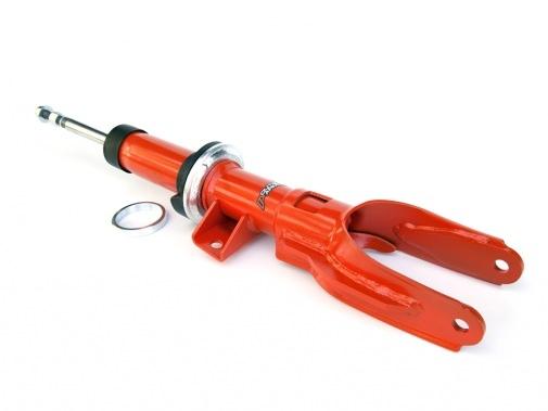

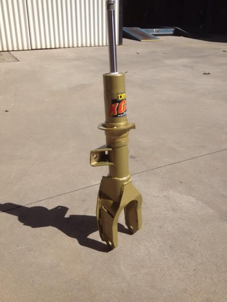

                          Note also, they have seen failures with the top nut snapping of on several Amaroks as well as the shock base folding, snapping CV's. Your call but the Billies are a MUCH more robust unit. See the photo on page 1. Even more noticeable in the flesh. TJM, revised their shocks after simular failures but I am not convinced (doubt) they are an equal to the Billies yet. Furthermore, only the Billes from this group are rebuildable.
                          Old TJM strut
                          Revised TJM strut
