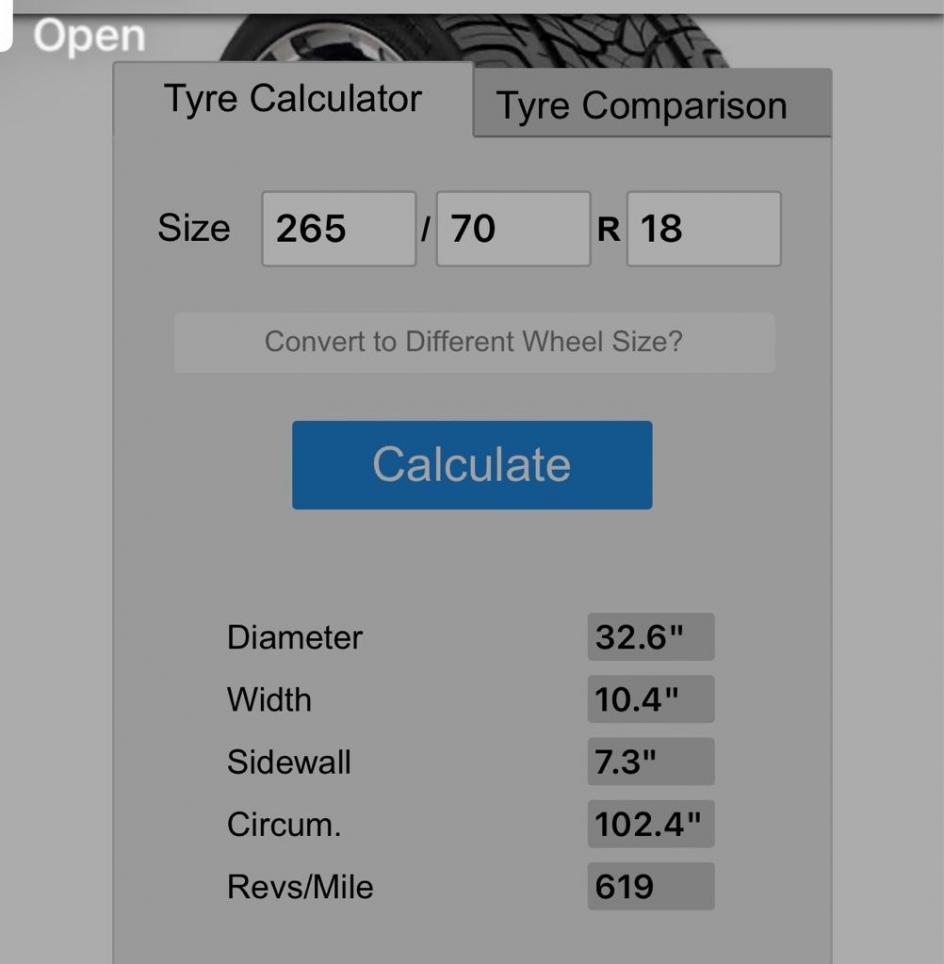

                  If you keep your 18” rims you can get 265x70R18 which is a bees Di ck under 33
