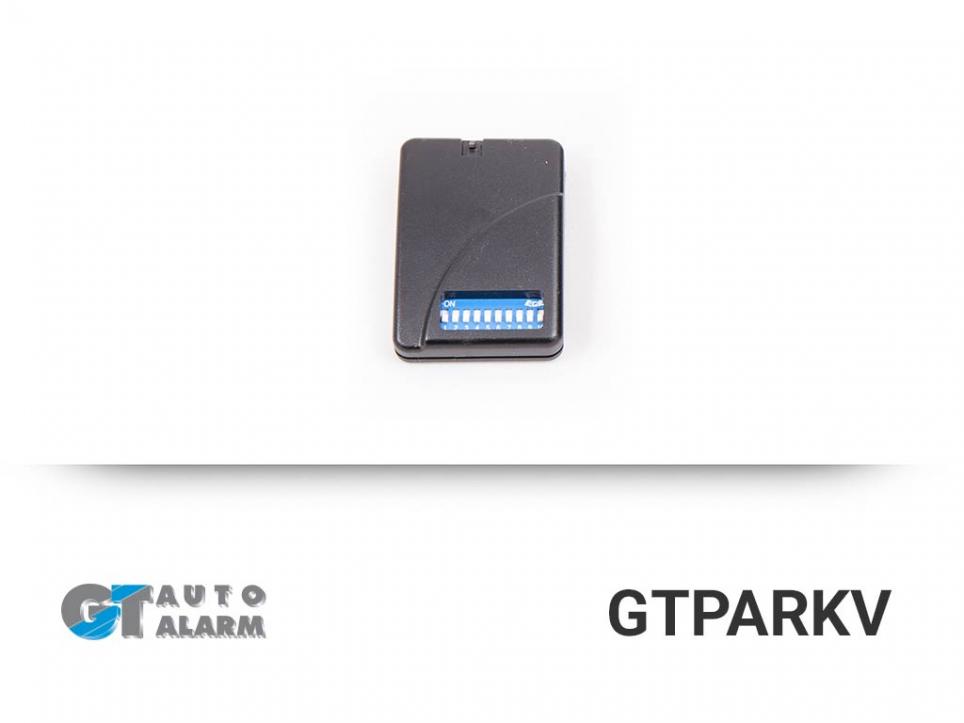

    Hi,
    VW dealer has retrofited a GT Alarm Park View OPS system for front and rear.
    It works like OEM, but with VAGCOM I can't access module 10, Park Assist.
    How can I access that one?
    It's not possible?
    Thanks.

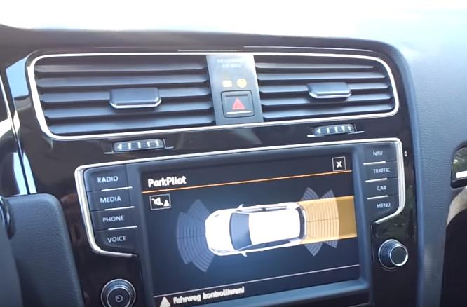

      Also anyone can say me how to activate this type of representation:
      Instead
      Best Regards,
      Chirag Geiantilal
      '06 - Volkswagen Passat 3C 2.0 TDI Highline - 2009 - 2017
      '12 - Volkswagen Golf VII 1.6 TDI Confortline - 2015 - ...

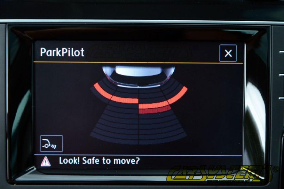

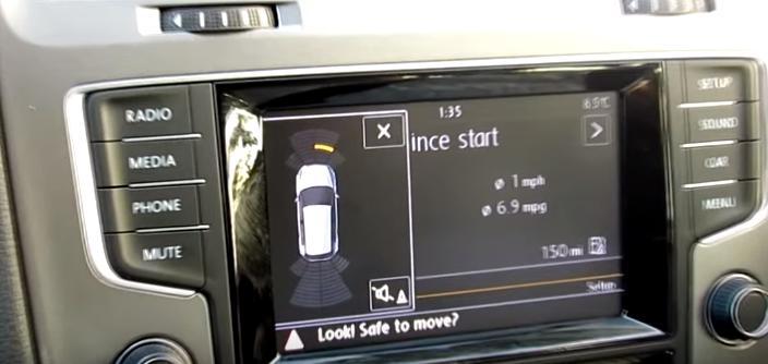

        Cgentil, I also have one GT Alarm Park View OPS system and would like to change the representation from:
        to:
        Do you know if it is posible?
        Thank you
          Hi,
          Do you have front and rear sensors?
          Also do you have dynamic guide lines?
          Cumprimentos.
          Best Regards,
          Chirag Geiantilal
            Only rear sensors, that's why i would prefer the representation only with the rear sensors.
            What do you mean by dynamic guide lines?
            Cumprimentos
              Cumprimentos
              Do you know where the module is installed?
              It's simples procedure. You should have both front and rear activated you just have to activate rear! I'll PM you.
