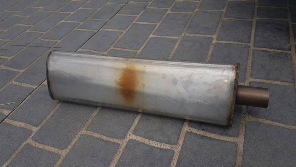

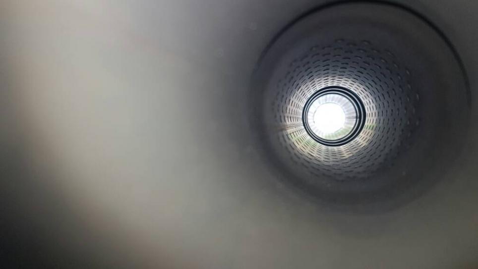

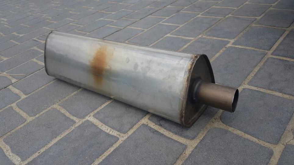

                      So finally I got the resonator removed.
                      Myth 1. The resonator is just a straight through pipe. There are no holes it just dampens the noise.
                      My take on it is that this is incorrect partially. The pipe is perpetrated inside and yes it dampens the noise but with the straight through pipe that's been welded I'm not sure if it's going to change any fuel usage or anything else. Time will show.
                      Myth 2. It pips and crackles like the gti or r models.
                      No it doesn't. It does pop when shifting gears but not as loud or aggressive as the gti or r models
                      Myth 3. You'll get some drone
                      Well I tried the entire rev range and I haven't had any drone at all.
                      Myth 4. It gets loud and to some it may be too loud.
                      Not unless you remove the muffler as well. At idle it sounds stock with a slight note. The way I can describe it is its like a stock exhaust with a deeper tone.
                      Sent from my SM-G935F using Tapatalk
