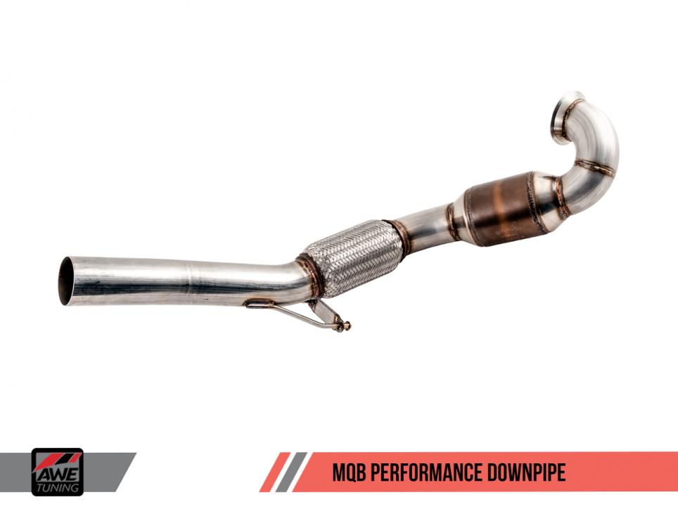

Hello, people of Australia.
Just want to chime in with a data point from the states, because this thread in particular has been so chock full of information on this issue.
I just installed an AWE downpipe. Not sure if you're familiar with this brand, but it's from one of the only companies in the states that guarantees no CEL without a Stage 2 tune. So I'm running with this downpipe, and the rest of the car is basically stock: no tune, stage 1 or otherwise.
Rattle is still there. If there's any doubt, it's much like vw747's report (YouTube) with a faint, high-pitched ting-ting-tinging on load; particularly bad going up hills.
Dealers here don't seem to have the patience to diagnose this issue, and as far as I know no TSB/Recall or any word from VGA on it either.
