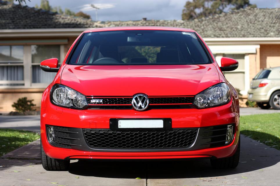

                Thanks to all for the info in this thread. I spoke to Philip from Lakin who is extraordinarily helpful and professional.
                In summary:
                GTI and R are shipped with a wide front baseplate (drilled to suit European plates, way too wide for standard Qld plates); dealers will fit normal plates onto this baseplate.
                The rear of the car is completely pristine. Dealers will drill holes into this panel(and usually deeper into the bodywork of the frame) to fit standard plates.
                Lakin make custom plates for the Mk7. The rear is easy: drill small holes through the panel, fit baseplate, attach plates with or without covers (recommends do this yourself, don't trust dealers).
                For the front, he makes a baseplate to fit the predrilled holes, which protrudes 75mm each side of standard plates (as in the photo above) OR you can buy (expensive) custom colored plugs to fill these holes, and drill narrower holes for a perfectly fitting baseplate to match plates with or without covers.
                I will go for the wider plate as in the photo.

                        The photo above is of my car. I also have a rear bracket, and as Tony says, it's there to provide a better base for the numberplate, but also to provide another mounting surface should you wish to fit different-sized numberplates in the future without drilling more holes in the bumper. It's virtually invisible behind the plate though; here's a photo showing the rear bracket from the side (click on it to get the full-sized original and look at the plate up-close):
