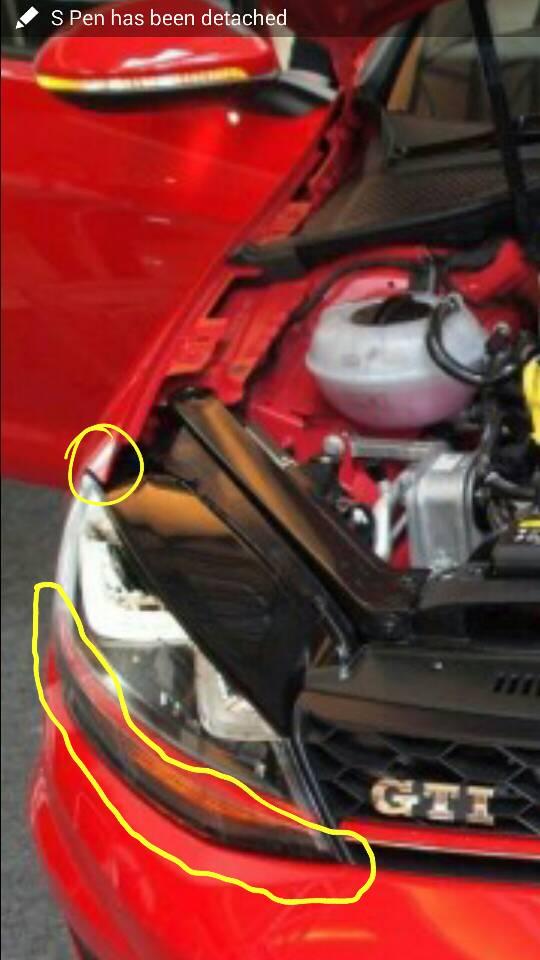

            • A little observation and adjustment I've made during the install:
              Make sure you put automotive tape(painter's tape) on the corners of your front fenders and the front bumper(circled bit) as you will more than lightly bump into them during install. Also don't take the plastic sheets off your headlights until its been hold in place by two screws as this will protect you new lights a little bit more.

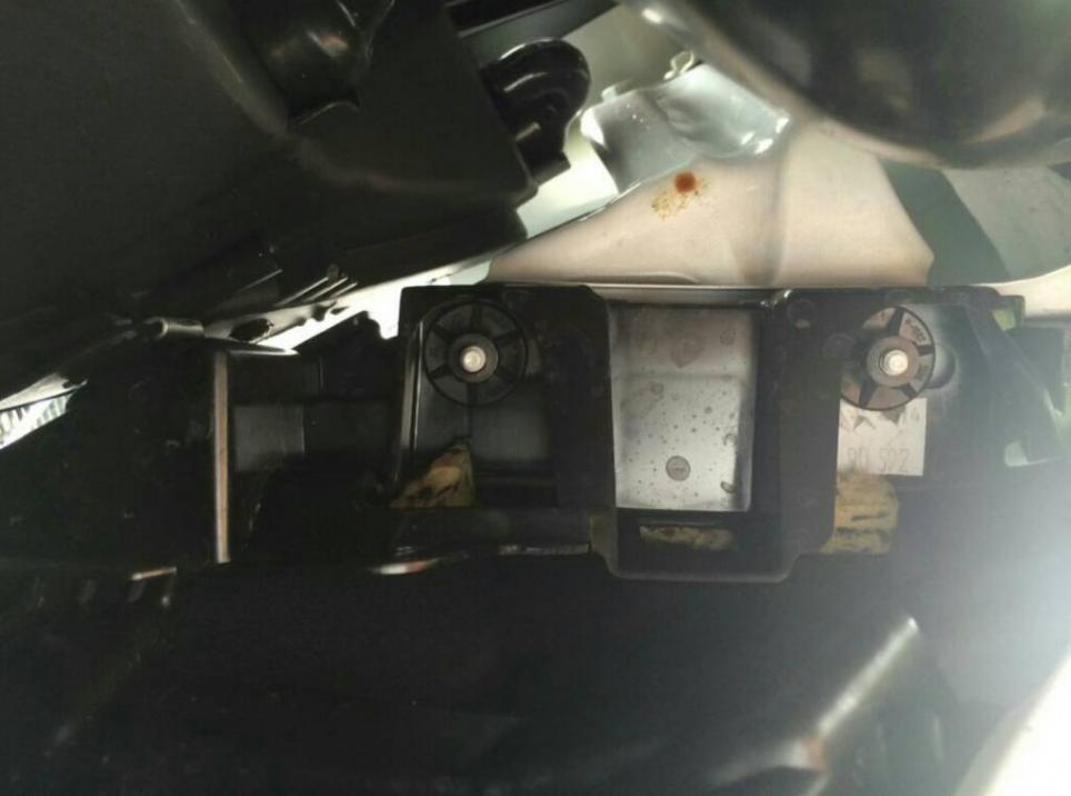

                          • how'd you guys reach the two upside down screws on the sides of the bumper?
                            2018 Golf 7.5 110TSi Comfortline | Drivers Assistance Package | Retrofitted: Traffic Jam Assist | Emergency Assist II | Light Assist | OEM Vienna Leather Sports Seats with full Highline Interior | Power Folding Mirrors
                            • 10mm ratchet with or without extension mate.
                              • These two right?
