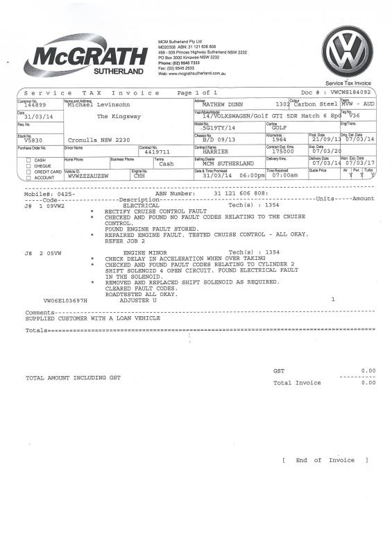

              Got my GTI back this morning. The service guy told me there was a stored engine fault which was affecting the cruise control, and some problem with a sensor in the accelerator (a problem I was having with some very non-linear acceleration).
              Here's the invoice (some of my personal details removed for privacy!) showing what was found & done.

                      Good news. The car is very clever though....the solenoid in your drive-by-wire system wasn't working properly so it also disabled the CC system. Excellent and interesting...
