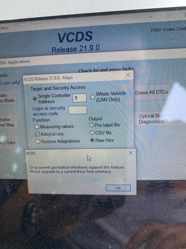

        There you go. Forum won't let me upload the csv file. My VCDS interface is too old to do an actual hex restore file.
