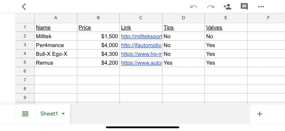

          This was a summary I made for my Mk7 R wagon when I was working out how to replace the fake tips and no valves. Really only Remus does it. Need to hear one in real life though, because the videos sound like a kazoo. And $4,200 is a lot of whisky to help me forget I’ve got fake quad tips.
