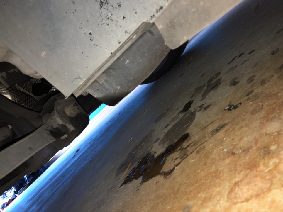

    Hey, not had any problems for a while and never had a fluid leak, until now.
    On the timing chain side of the engine just below the bottom pulley I’ve got a small pool of clear fluid just on top of the plastic under tray and a small pool now on the floor. The fluid is clear but not water as it is thicker and seems lubricated.
    Attached is a photo. You can just see the dampness on the plastic tray and the pool below. My first thoughts are break fluid but the reservoir is still full. Are there and other clear lubricate fluids on this left side of the engine?

    Coolant?

      I’ve just googled and yes clear lubricated fluid is from water pump leaking even though it’s not pink. Damn it! Could it be anything else PLEASE????

        Bit of a long shot but windscreen washer fluid leaking and picking up oily residue on way down?

            Water pump, my mechanic showed me dripping down the side. Not going to be cheap....

                  I’ve been quoted $725 for the water pump and thermostat housing. It’s recommended to do both at the same time. It’s also recommended to get the pipe that goes from the water pump to oil cooler as these break easy when doing the job and any belts that come off I’m putting new ones back but it’s not the timing belt and these gen 3 ea888 are chain driven. My mechanic snap on tool says 2.5 hours for the job. All he has to remove is the washer water bottle to get some more room to move.

                        Ok after having the cracked thermostat replaced another coolant leak has formed. My mechanic pressure tested with no luck but thought if only has to be the oil cooler, so we replaced the oil cooler and after 2 weeks I still have a slow coolant leak. Any ideas what else it could be or somebody else had a leak in a different location?

                          What are your symptoms ?
                          If there is some coolant pooling around the engine look for a pinhole leak in a hose or slightly loose connector? Engine might need to be hot and running to be located precisely (Be careful !)
                          If it is low level of coolant in the reservoir then it might just be airlocks in the system being purged after engine has been running for a while (common on these engines).

                            Cheers mate, I’ll investigate. Looking under the car it’s just little drops off the left hand side plastic skid plate and leaves about a 10cent piece size pool each morning, although this morning there was none. Fingers crossed it was just air.
