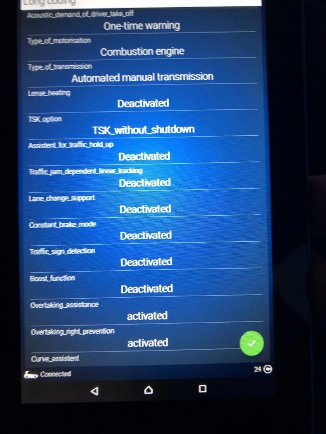

    Is it possible to disable this via VCDS/OBD11?
    ACC is slowing down not to overtake using right lane - which is allowed in my country.

    Yes. See adaptions in module 13
      Which channel is that? I can only see something like Predictive speed limit regulation.
        That only puts a tick box in the acc menu, I think the guy meant long coding not adaptions, there is a lane change support and a overtaking assistance and a overtaking right prevention settings in there, not sure what they do
        What at does it do, does it cancel braking if you put the indicator on?

          It slows down. Stops slowing down if i push accelerator or res button.
          What's the bit and byte for overtaking right protection? I dont have description in vcds.

            I’ll have a look tomorrow for you, but my car does stop slowing if I press the accelerator or it I put the indicator on if I want to overtake, but slowly unless I have it in S mode on the DSG
              that any help
                Thank you, all I need!
