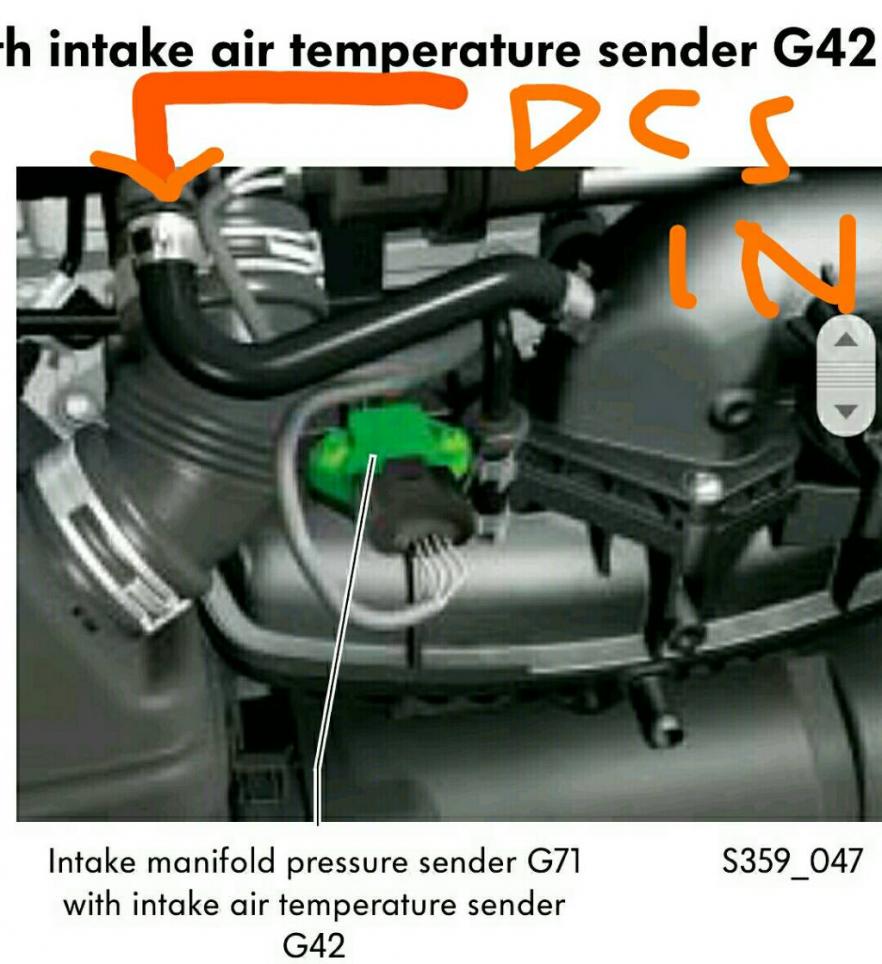

    I want to do a DIY clean the intake manifold and hoping it will also clean some part of the intake valves using a foaming engine conditioner (they sell a Japanese's brand over here called DCS engine conditioner).
    Currently I'm running with Amsoil PI to clean the injectors (1 bottle for full tank and will do half bottle for another half tank).
    So intake cleaning will be next.
    The last will be combustion chambers decarb thru plug holes.
    Can anyone suggest the easiest way (and also shortest path to the valve)....which point I should spray this foam.
    I noticed a member posting a DIY for 2.0 GTI by removing IAT sensor and spray thru the hole.
    How about this engine?
    I am thinking to spray via a breather hose's mount beside the intake temp sensor G42 on the backside of the engine.
    Any opinions ?
