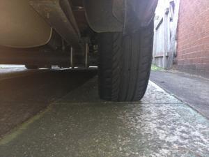

        This is what has happened to the tyres on my MY11 Caddy Maxi Life. The dark parts on the inside of the tread are where the tyre is not contacting the road. This was reported to the dealer at the 15,000 km service and they shrugged their shoulders and said "it was standard for that type of vehicle"! Tyres have been inflated at recommended pressures checked each time refuelled.
        Now at 32,000 km I have to replace them. The issue for me is that they have to have a load index of 94, and the majority of tyres have a load index of 91.
        So far, I have managed to track down:
        Toyo Proxes 4
        Toyo Proxes C1S
        Toyo Proxes T1
        Maxxis MA511
        Maxxis M35
        Maxxis IPRO
        Continental ContiSportContact 2
        and
        Roadstone N8000
        Any thoughts?
        Left Rear
        Right Front
        Right Rear

          Directional and asymmetric are different things. Bridgestone RE050s are directional tyres, but symmetrical. They are not asymmetric.
          My RE050s started the well-described 40km/h rythmic thrumming within the first 12 months. I reported it at the first service, was told it was probably the tyres, and would probably get worse if they were rotated. I told them to rotate the tyres anyway, and the noise became worse. And has continued to become worse.
          I work somewhere with a 40km/h limit, and the noise is definitely worst at 40km/h. I don't notice it at 60 - 80km/h (travel both speed zones on my daily commute, and during my work day) but passengers regularly comment about the noise.
          VW shrug their shoulders about the noise. They shrug their shoulders about my DSG leaving me without drive. I like my Golf, but I have developed an intense dislike of VW.

              Well, Goodyear Dunlop got me to take it in for an inspection. It went the way I expected it to. They weaselled out of it.
              Now I had checked the tyre pressures just the day earlier. It was 39 psi at the service station with the new automatic tyre pressure inflators, and also read 39 psi when I got home and double checked it with a pen type gauge. When the tyres were checked by Beaurepaires (the agents here), he could only get 36 psi on his gauge. Funny, when I got it home, I checked them again after letting the car sit for around an hour, and guess what...it read 39 psi on all four wheels.
              Basically, they are saying that it is a wheel alignment issue. What I can't understand is why the inside tread blocks are not touching the road? The toe in is on the limit at -2 mm (i.e. toe out - VW say it should be +/- 2 mm), but I would expect that the tread would be wearing away, and if it is not touching the road surface, how come it is wearing?
              Anyhow, this combined with the fact that I have let it go for 32,500 km, they are not willing to do anything as they say that the tyres have a life of around 40,000 km.
              I did not really expect any other outcome, but thought I'd give it a try.
              Anyhow, seeing as there are not that many suitable tyres with a load index of 94, I have done some hunting, and one that looks likely is a Hankook Optimo K415. Seems to have some good reviews.
