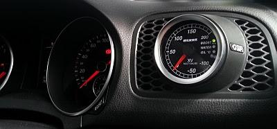

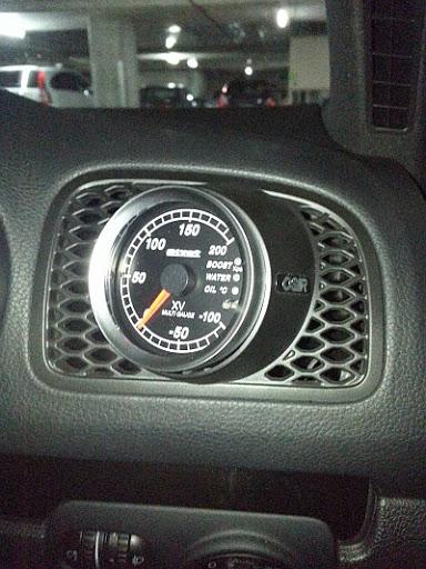

I know not everyone likes the look of the OSIR vent pod, but I think it looks alright?
If all goes well, the end product should look like this:
I haven't pushed the gauge all the way in yet, in that photo, which is why it looks like it's sticking out a bit.
This is a combined process with the OSIR RHD Vent Pod and a Pivot XV-A gauge.

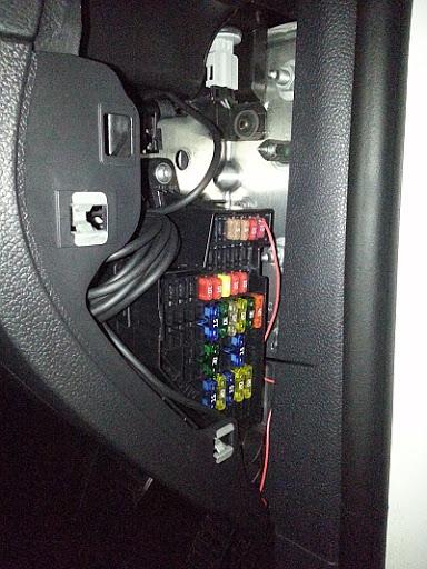

Open the driver's door and open the fuse box cover.
[Apologies, I didn't take a photo of this step earlier, this is from after everything was finished, but you get the idea]

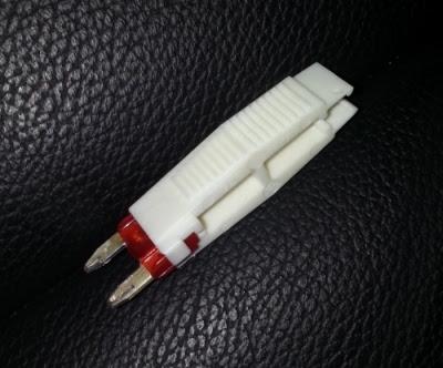

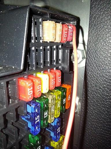

Locate the fuse pliers on the inside of the fuse box cover and use the bigger side of the pliers to extract the 10A fuse you'll use as the power source for the Gauge.
Connect the 10A fuse tap in place of the 10A fuse.
Run the power connector down to the ODB port where it will be connected to the gauge's wire loom.
Interesting I noticed all the fuses were inserted on an angle, you can press on the top of each fuse and then they'll sit flush ... wonder why that's so?

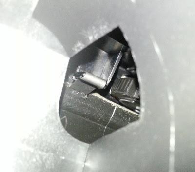

Ok, so according to the AWE video, you can press up from behind the dash, through the fuse box opening, with what appears to be very little effort and it should pop right out .
Here's a view into the dash cavity from the fuse box. You can see one of the clips holding the vent in place.

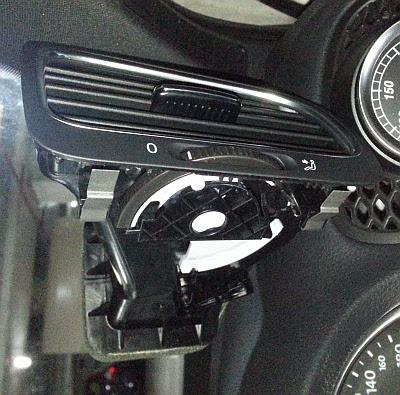

Here's the view of the 2 clips to be wary of.
This is what it looks like inside the vent cavity.

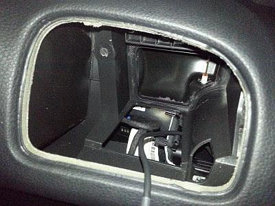

So now that the cavity is clear, it'll be alot easier.

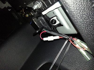

Feed the gauge's wiring loom from the odb port through to the fuse box area and back out the dash opening.
Tuck it in neatly along the dash lines.
I tied up the excess lengths and tucked it neatly away. (See 2nd Image).

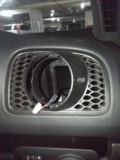

Snap in the OSIR gauge pod.
It has plastic clips in the same locations the factory vent had metal clips.
Connect the cable to the back of the gauge.
Position gauge in the vent pod.
Connect fuse tap power source to wiring loom and tie off unused aux connectors.
Snip off the left over bits of the cables ties and neatly tuck away the cables, aaaaannnnnnd .... Bob's your auntie!
I think it looks uniform with all 0's at 7'o clock.
[Apologies for the photo quality. Photos were taken with my phone in the dark]
