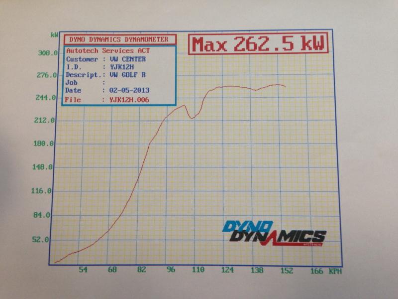

Power: The power is, as you'd expect, amazing. We haven't put the car on the dyno yet - APR recommended putting a few hundred kms on it first - but the specs say it should be somewhere around 315kW at the flywheel. Keep in mind I came straight from a Stage 1 chip (no hardware) to the full Stage 3 kit so it's a big jump on this car.
The Autopolar boost gauge shows about 30 PSI peak boost.

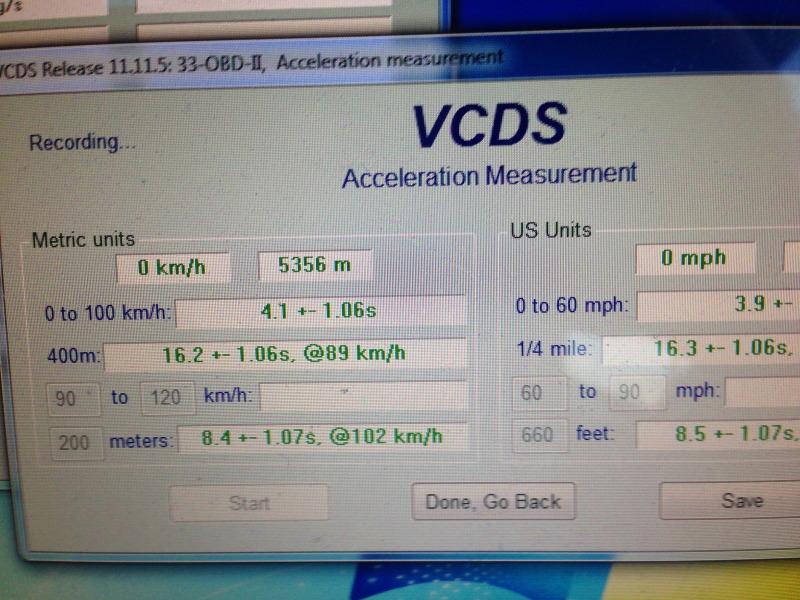

Performance: First run 0-100kph in 4.1 seconds.

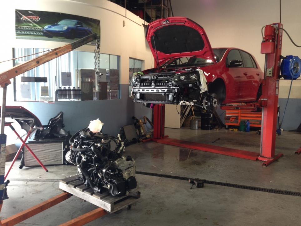

Engine out ready to work:

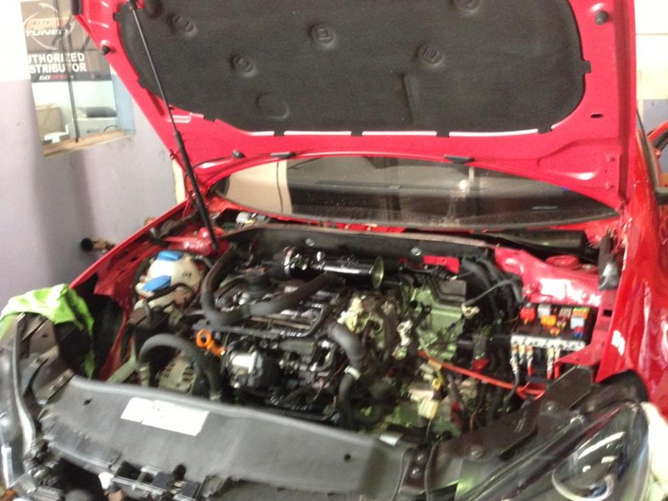

Engine back in the car (sorry for the blurry pics - they're great mechanics but not so great photographers

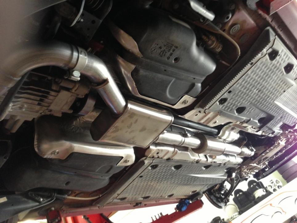

APR full RSC exhaust:
