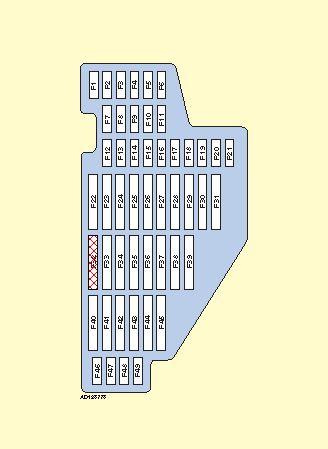

      Look inside the car on the side of the dashboard there is a cover that you remove. It's fuse no.32 marked red in the picture.

        If both of you had not said it was on the end of the dash I would not have found it in a month of Sundays. How many fuses can one car have? Pity it is not pointed out in the manual.
        The layout is mirror image to the diagram... but it pointed me in the right direction... mine has one or two more rows, but I found a dead 20amp near the bottom. Of course no apparent spares.
