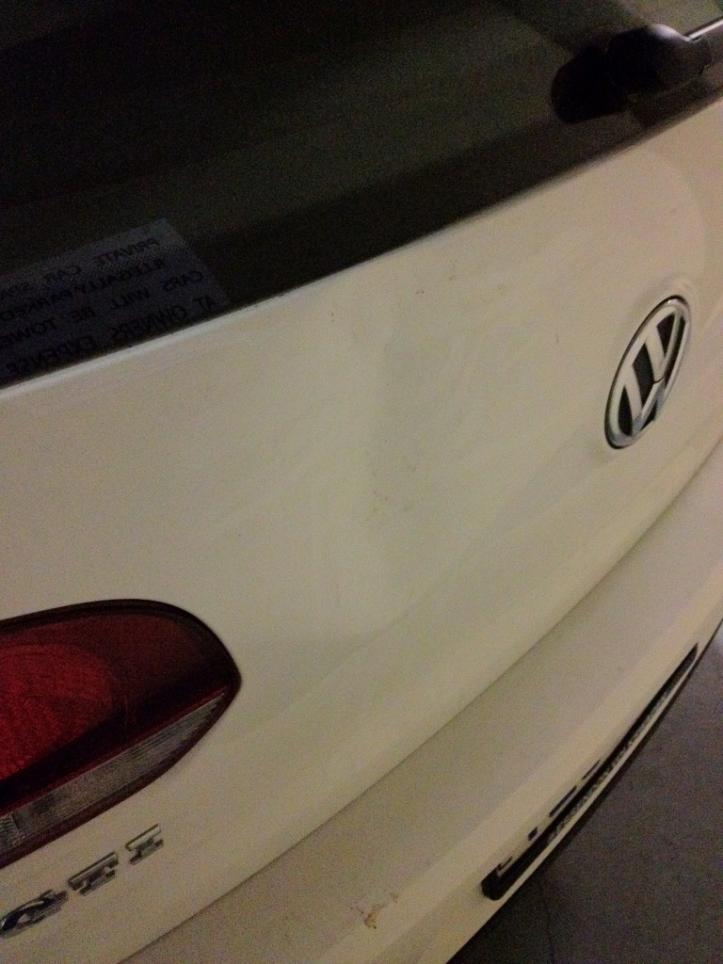

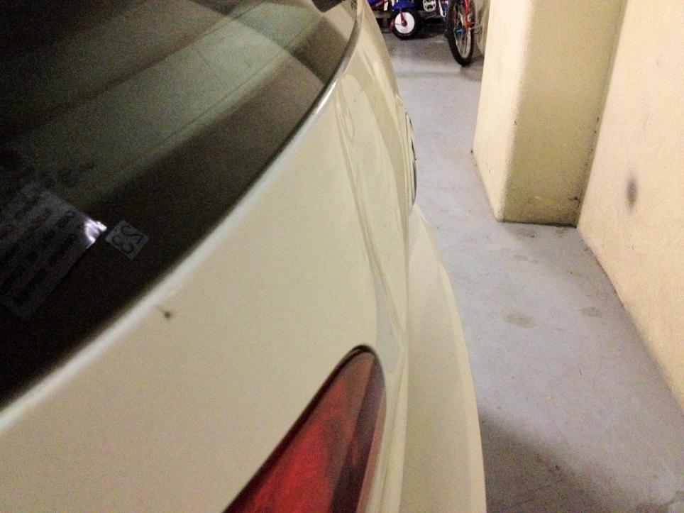

    Hi All,
    stressed and in a rush i reversed into car space at a local golf course and bumped into a tree sticking out....
    very annoyyed at myself, i've got a couple of pics - just wondering what your thought's are on:
    Cost / difficulty of repar?
    Worth using my insurance (AMMI - just chcing on excess now)
    or perhaps just sourcing a relacment planel?
    Its about 7 - 8 cm's across and 3 -4 cms deep, i'm conerned that the panel is curved and if the paint chips off then it will need repainitng which makes me think about just replacing the panel (any standard white mk 6 golf panel would do)
    thought's or similar experinces..? thanks in advance and take care parking!
    and then on the way home i got a tiny stone chip at the base of my windscreen (I heard it and thought oohhhh sh****tttt!!) but luckily its tiny, should i leave it or repair ? its at the base of the windscreen near the dark vinyl so not in the main vision area etc - can they crack and spread?

    I'd take the trim off and see if it will push out — often, if the metal's not creased and stretched it will spring out as easily as it went in.
    I've sometimes succeeded with only hand pressure.
    As to the stone chip, it might or might not spread — if it's only a surface chip it probably won't, but I'd have an expert look at it.
      Don't push it out yourself, you will make it harder to fix, the paintless dent remover guys should be able to easily fix that.
      Manual MY12 RB Golf R | Bluefin Stg2 | Milltek turbo-back
        +1
        Know someone who tried to push a dent out that would of cost in the hundreds if done by a PDR, ended up in the thousands after having to replace the whole panel becuase he stretched the metal.

                          What did the PDR mob say?
                          Simply replacing the hatch might work but it isn't always just a matter of undoing some nuts and bolts. Firstly, undoing the hinges will damage the paint on the hinges and on a white car this will stand out particularly if they start to get a bit of surface rust afterwards. Touchup paint will help but the more you apply the worse it looks. Secondly, you'll probably find the paint colour will be ever so slightly different even if it is the same code. BTW this probably won't become apparent until the new hatch is actually installed. Thirdly, and possibly the most significant for me, the hatch from another golf may fit but many of them would get tweaked during assembly to properly fit the specific car they're fitted to (usually twisting/bending). So there's a possibility a replacement hatch won't quite get that factory fit and finish like the original unless you take it to a panel beater afterwards.
                            Well, the PDR guy's i've emailed pictuers too - all have said its too big a job for them to do, i might have to revisit that though....
                            thanks for the heads up on the tweaking of the boot fitment - that does makes sense
                            to be honest it a good price so i might just do the swap and see how it is (its also a white GTI boot)
