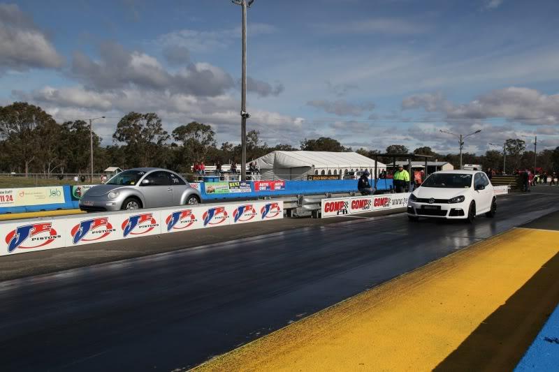

    There has been much speculation about the new Golf R that has been purchased by myself to build into a quick daily driven Golf R. Im hoping to have it completely finished towards the end of next year but will have most of the power additions finished by Sydney drags in late February.
    So, the factory specs are as follows:
    2011 Candy white,DSG,Recaros and 3 door.
    The modifications so far are as follows:
    Miltek race downpipe and Golf Racing intake
    Wheels are RS4 replicas (borrowed from Sebs S3)
    Torque mount
    To come in the next fortnight:
    S3 front mount,Autotech fuel pump,RS4 fuel pressure valve,Re-code tune,2 piece discs with lightweight brake calipers, 17 inch Fujin wheels.
    To be done by Feb:
    Titanium exhuast,KW V3s,BSH engine mounts,custom intake,Aluminium intake manifold,multi-point water-meth injection,carbon fibre hatch+bonnet.
    Although only in possession of the car for 4 or so weeks its already racked up 5000km and done a round trip to Warwick raceway where it helped me pick up 3 trophies. With a best time of 8.35 @ 84.75mph it knocking on the door of a 12 second pass on the 1/4, all without a tune!
    It will continue to be modified and become faster as time progresses but until then I'll enjoy it as it is and await for new parts to continue arriving and patiently wait for chassis development to continue being carried out on it over the coming weeks.
