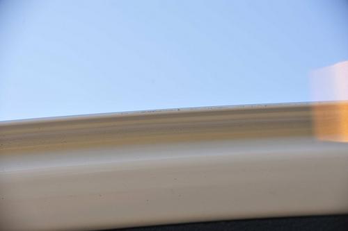

    Recently when i washed my car i found some scratch on the boot and the rear bumper,i did not found any contact between them,but it must have been contact in some situation.i am confused.I have taken some photos of them.may be this can help me and others.
    The scratch can only be found on the left hand side of the bumper and boot,from the picture above it is clear to see a smaller gap on left hand side than right hand side The scratch can be found on both boot and bumper in same place.I forgot to take a pic of the bumper, maybe tomorrow i will take one.How to solve this problem should i let the dealer to adjust the bumper ?

    If the gap is uneven you should definitely take it back to the dealer.
      I've renamed the thread to "Hatch alignment issues" so that it's meaningful to people browsing and searching.
      I can't recall anyone complaining about this issue on a MK6, but I agree with Alok, there is clearly an alignment issue, so take it to your dealer's service dept.

        Thanks a lot for this,it is what i mean,sorry for my poor English.
          Thanks for this,i will take it back to dealer in this week

              Probably the bumper is not clipped in fully.
              Try (on the left hand side w/ small gap) pushing down the bumper and pulling out at the same time, followed by pushing it back in to seat in fully.
