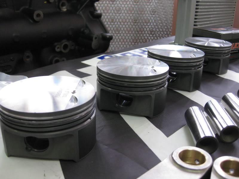

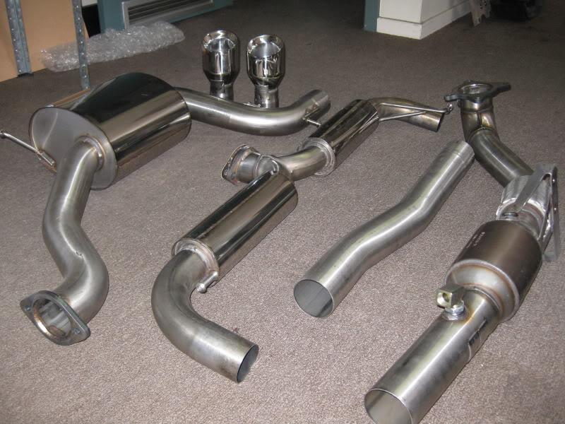

                                The last parts have finally arrived. Pistons included.
                                More bits, Snow performance W/M kit, Mocal oil cooler
                                Mahle Motorsport custom 82.5mm 9.5:1 CR Forged and Coated pistons.
                                DM Forged rods, calico coated bearings, ARP studs everywhere.
                                Prepared block.
                                Head with plenty of custom bits
                                Custom modified MILTEK 3" race system, 3.5" DP.
                                The parts are all off to the engineer for balancing and clearancing. The block will be honed and then assembly will begin
                                Also, stock vs. aftermarket rod+pistons.
