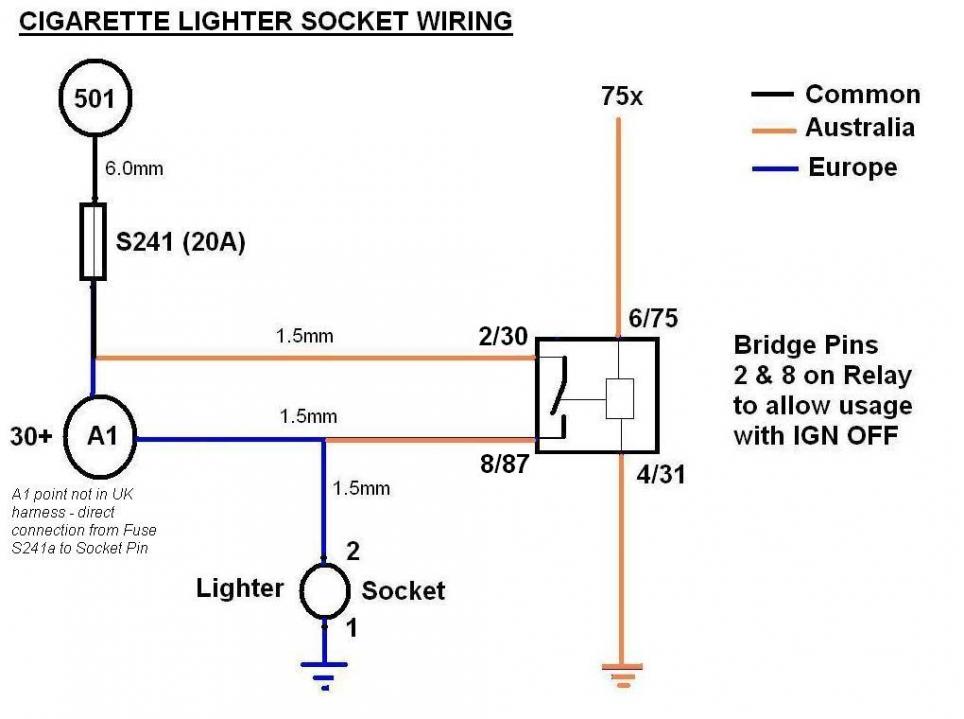

          Anyway you can just wire it up with the lighter feed coming through a relay activated by the 75x (ignition) feed similar to the Mk IV way:
          In Europe the cigarette lighter was active all the time (blue wiring in above diagram).
          The relay you need is part number 4H0 951 253 A with the control number "645" (same as old "53" relays, now superseded)

            Originally posted by graeme86 View Post
            The Mk IV's lighter was only live with the ignition on.
            Thanks for that, only where does this happen? Please don't take this the wrong way. Your help is appreciated.
            I take it that 501 is supply from the battery, and that this normally goes through fuse S241 to the lighter socket.
            Where 501 located, and where is S241 located?
            Now to the feed 75x. Where is this located? Does this have to be connected through something like a Scotcklok?
            As for the relay, where does this then end up?
            • #36
              The diagram refers to the Mk IV connections
              501 is one of the screws on the relay plate labelled "30"
              S241 is Fuse 41 in Fuse Box on side of dash
              75x is ignition circuit (off with starter) - screw connection under relay plate
              Relay in Mk IV is plugged into a spare relay point in the Relay Plate under dash.
              You just need to find equivalent connection points in the Mk V - all of these are in the fuse/box relay plate in engine bay (?)
              In fact you just need to intercept the wire going to the socket and re-route it through the new relay - that part of the circuit would already have the feed and fuse in it now.
              Then you just need to run a new 75x feed to earth via your new relay coil.
              Please dont use a "Scotchlok" for this sort of stuff
              PM if you are looking for: R32 rear sway bar; R32 suspension springs; Euro Headlight switches
