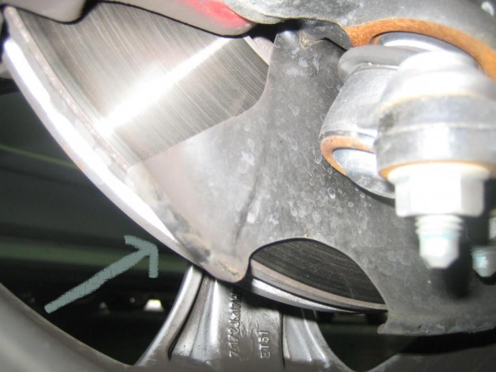

Now I'm hearing an intermittent grinding noise from frontend when braking at low speed. It sounds like metal on metal. Had the dealer check it out and they did not hear it on a test run so told me there was nothing wrong; said it was probably just dirt.
Next day noises were back and it seems it's only when you are rolling along in traffic or below 50kmh, it grinds and squeals as you brake and continues for a small amount of time as you take off. It's loud enough for pedestrians to stop and look at you. It sometimes sounds like something is loose. I've got it booked in at dealer next week for another look. I reckon it might be dodgy front caliper or handbrake? It also has regen braking, so I wonder if this is to blame as it's new to Oz golfs.
Anyhow, it has slightly spoiled an otherwise ace car. Anyone else has a problem like this? Any suggestions on what I should be making sure the dealer checks out next week?
