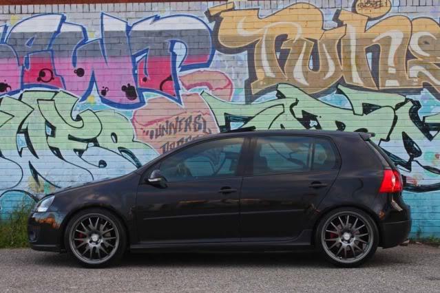

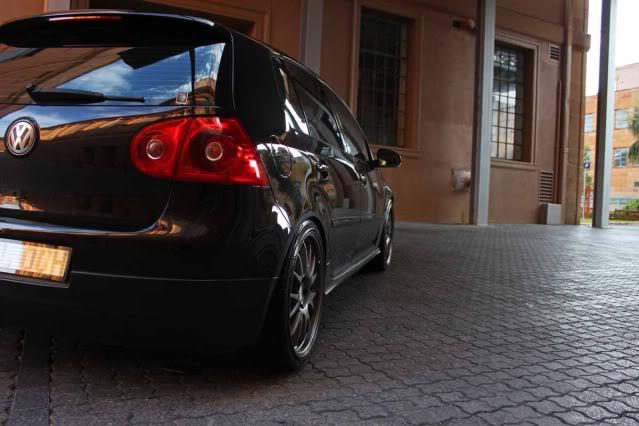

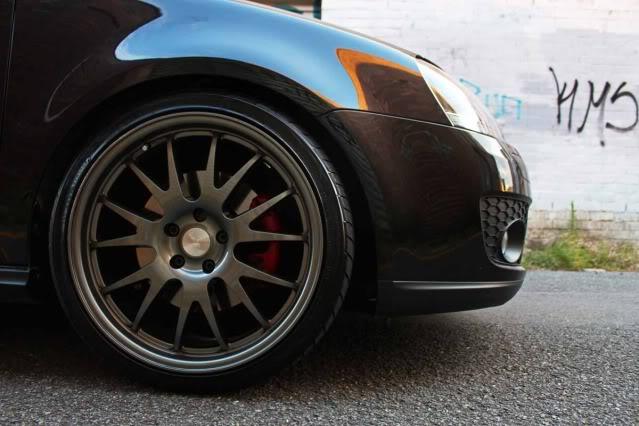

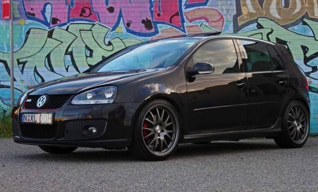

    Honestly....my old man (he is 59) has KW V3's and at present the ride is better than standard (MkV GTI) and he has 235/35/19 tyres on 19x8.5 wheels.
    Standard suspension plus the new wheels and tyres was a bit harsher, but the car now rides better than standard, is much better when cornering and looks like this:

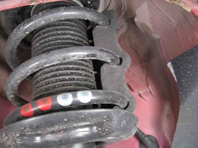

                    have they removed the shipping blocks out of the springs?
                      Oh yes! Another good suggestion! We've seen that a few times here too! hehe
