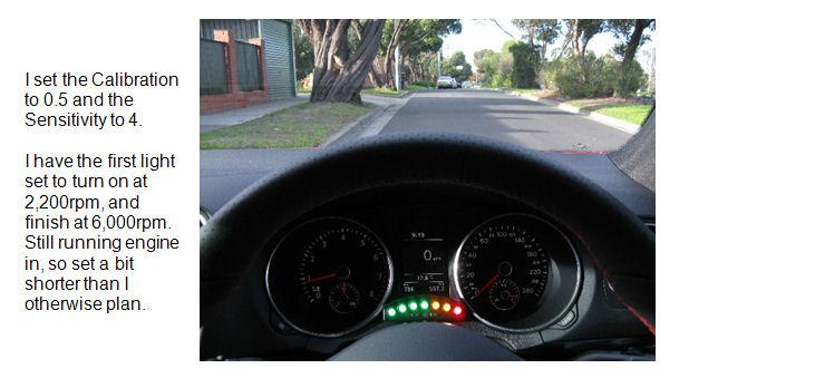

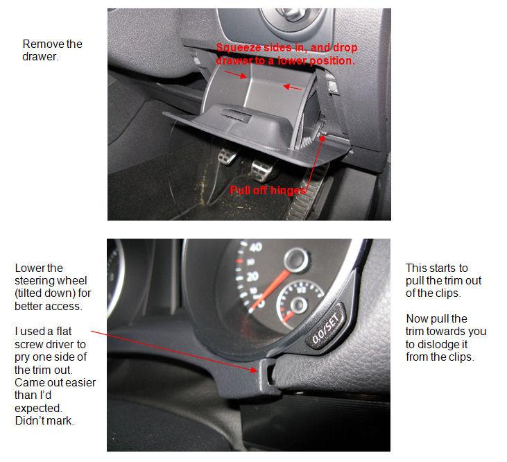

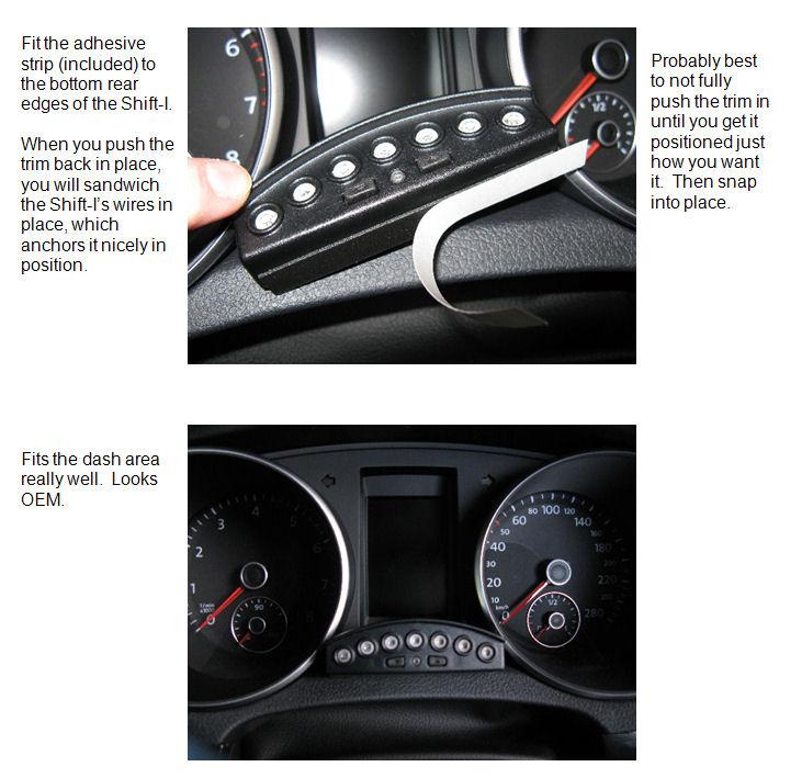

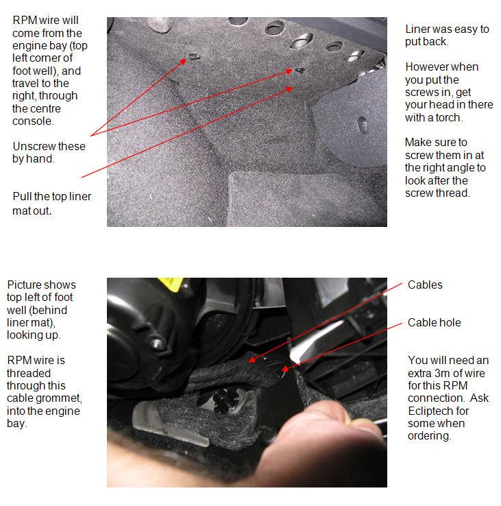

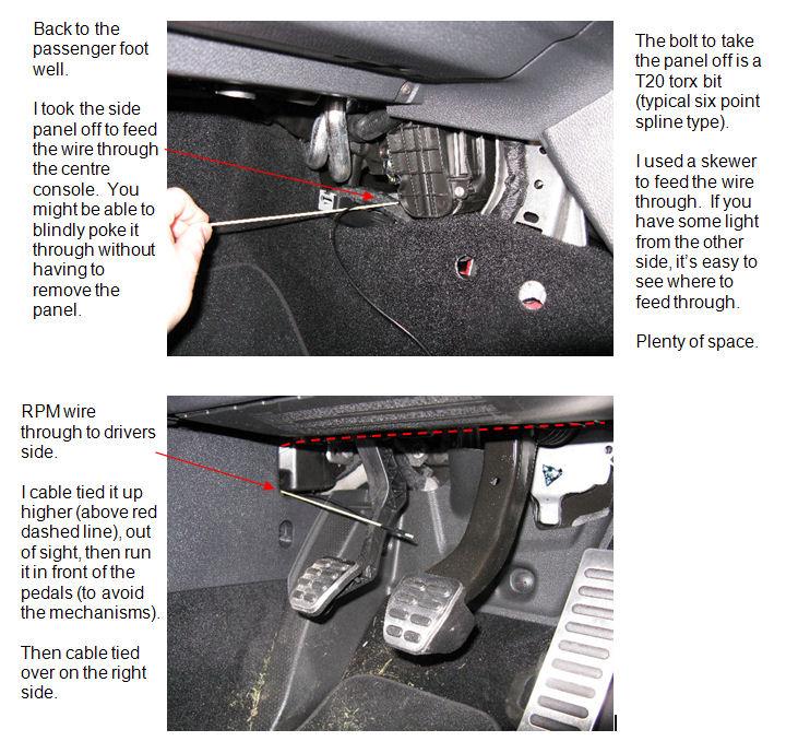

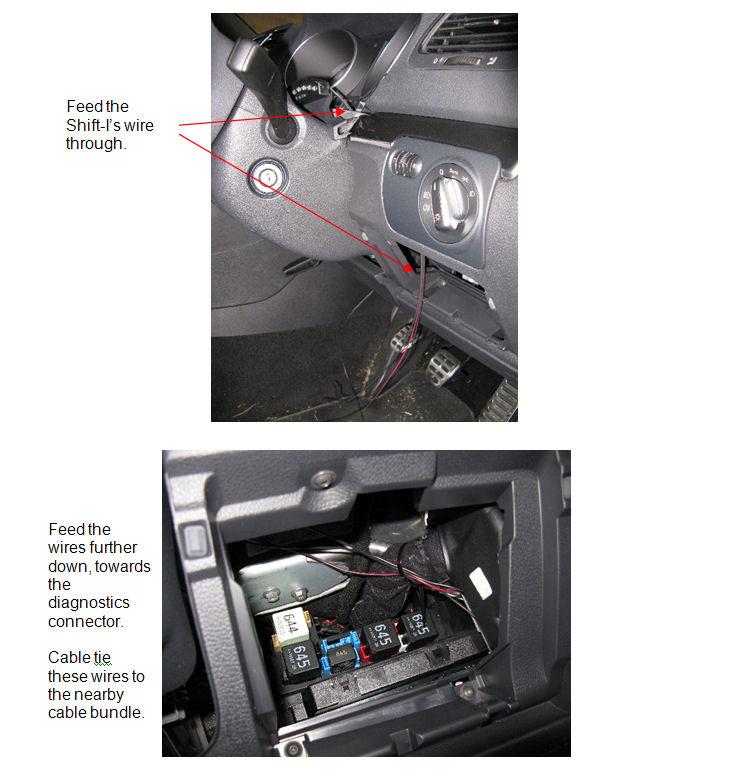

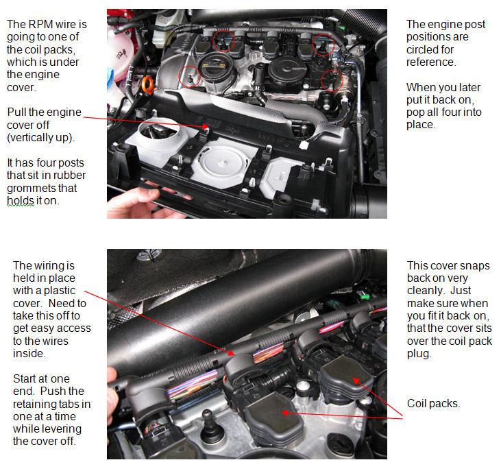

    I fit a Shift-I shift light yesterday and have put a fitment guide together. Thought others may like the info for future reference, as it may also be handy for installing things like dataloggers or other accessories. Think it took me all day to write this, so better get back to work If I've left anything out, please let me know

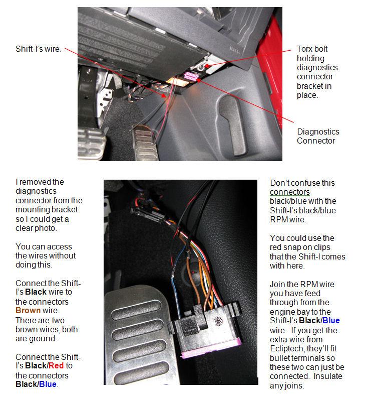

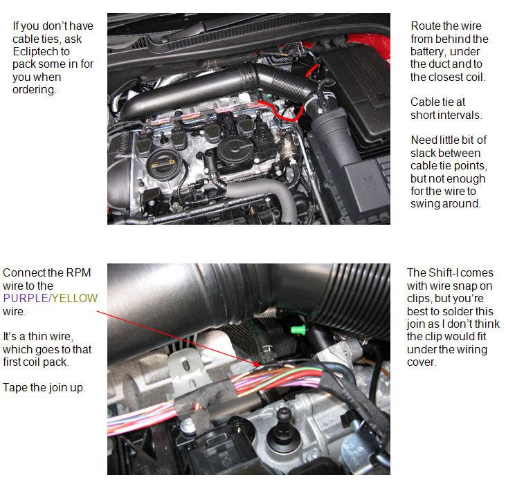

    You need 3 wires to fit the Shift-I to the GTI. Power and Ground from the diagnostics port (near driver’s side knee) and the RPM signal from the engine bay. I’ve included a heap of pictures, stepping through the installation. Use this guide at your own risk.
    This is fitted to a right hand drive vehicle. Routing of a left hand drive car would be a little more straight forward.

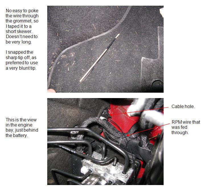

    First step is to install the RPM wire. I started in the passenger foot well. Poking one end of the wire through to the engine bay, and the other end through the centre console to the driver’s side.
