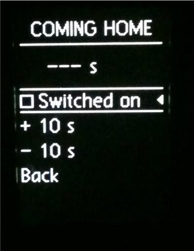

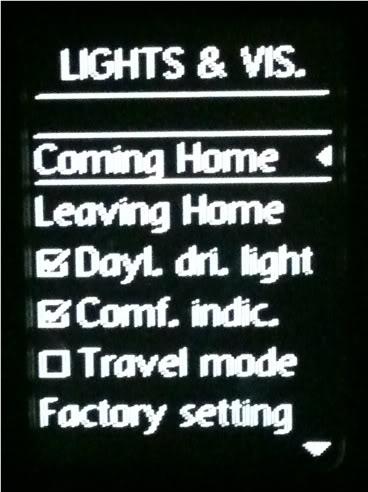

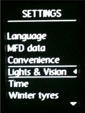

                              that's the current behaviour in the octavia as well - no need to flick the high beam. just have to make sure the light switch is set to 'auto', and the CH option is checked or turned on (maxidot -> setup -> lights and visibility). The default duration is set to 10 seconds, but this can be altered as well.
                              the same can be done for Leaving Home function.
                              looks like the convenience module its different to that on the golfs.
                              this is from the manual.....
                              Switching on Coming Home Function
                              – The light switch is in the position automatic driving lamp control ("AUTO") and the low beam illuminates.
                              – Switch off the ignition.
                              – After opening the driver's door, the function Coming Home is switched on.
                              – Close all the doors and the boot lid and lock the vehicle. After a short time, switch all lights off.
                              The lights go out 10 seconds after closing all the doors and the boot lid.
                              If a door or the boot lid remains open, the lights go out 60 seconds after switching off the ignition.
                              The function Coming Home is controlled with the light sensor in the mount of the interior rear mirror. If the light intensity is higher than the set value of the light sensor, the Coming Home Function is not switched on after switching off the ignition.
                              You can change the illumination period for the Coming Home Function by means of the information display.
