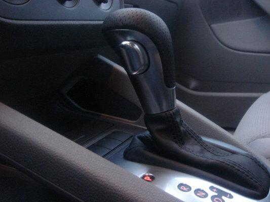

One fairly straightforward-looking upgrade is the Audi A3 DSG knob (which retains the silver button at the 3 o'clock t-bar position).
There are DIY threads out there to heat and twist the plastic rod inside the shift lever -90 degrees, to the 12 o/clock position.
Has anyone local done this? Many people just heated the plastic rod with a lighter until they could get a twist complete; others may have used a couple of heat guns.
DIY shifter replacement (using a manual boot or retain the DSG one) on vwvortex
Good step by step guide. Great result with the Momo knob!
If you don't want to do the 90 degree twist, use the A3 shifter. Would suit some cars:
VWVortex.com - Diy- A3 DSG knob and boot Retrofit
Anyone done either and have the shift button properly cabled up, per the guide?Bizi's Jetta TDI: Blue Graphite w. factory leather & tint, plus + Enkei Racing NT03+M + Yokohama S Drive 18s, Koni FSD, Neuspeed coils, GTI RSB + brakes, InPro mirrors, VW navi, Modshack. Come for a drive through the twisties on Saturdaze.
