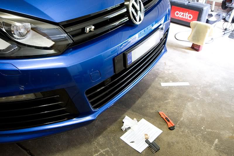

2) Removal of the front plate holder is just as Rob_R described it. If you don't have a steady hand with a drill, use a nail or something to mark the centre of the scrivet. Use a suitably sized drill bit (slightly smaller than the scrivet) and position carefully, then drill in with mild pressure. The bumper should only flex slightly, and after about 1cm just let it pull itself in so you don't hit anything behind (which you shouldn't really anyway.... you've got several cm until you do hit something)
3) Installation of Lakin brackets and covers
Corey sums it up fairly well. As long as you are centred all will be fine. Remember scrivet pin is the spreader for the four prongs on the scrivet button so you won't drill into the bumper. From memory you purchased Lakin brackets. What size plates are you putting on your car?Originally posted by langers_sydney View PostJesus Rob. A drill. Are you sure. Letting me loose on my new car with a drill! Hope its easy to do. Any tips?Golf R, Rising Blue, 5 Door, DSG and some extra fruit.

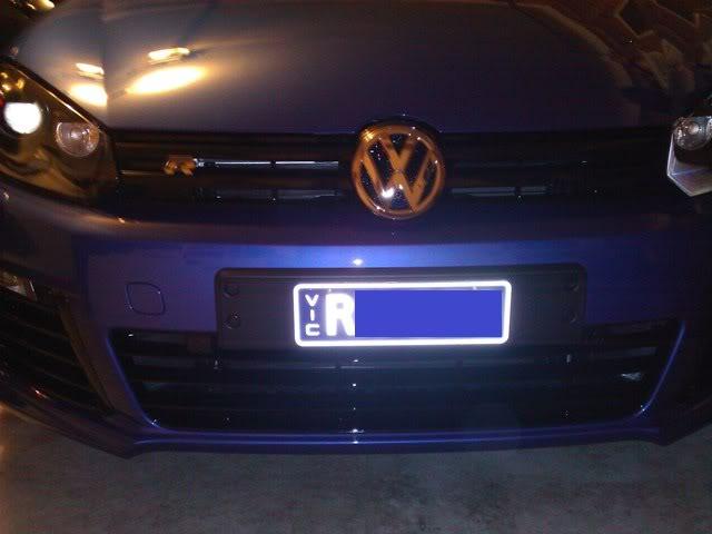

Well here is what the Lakin setup I've gone with looks like.
OEM bracket still fitted:
OEM bracket removed with black OEM scrivets:
Colour coded scrivets (also with full frontal venturesheild fitted):

God, what a mess that OEM bracket makes
Is it possible they changed this on MY12's or am I expecting too much ?
Not sure I like the "scrivets" but guess there is no other easy option
As ours is CW, I guess wrapping is an option or just bling the blank bits either side of the OEM bracket with something.
Never had this on my MKV -sucky8VSS2L/16 E9E9 XG MP SPP1 4ZD 6XK CSC5P with an extra free 10kW
I think there is no change to MY12's. Colour code scrivets was the only option I could think of without resorting to have the bumper filled and resprayed. You only really notice them when close up and I'm ok with them. Compared to the first pic with OEM bracket it is 95% better.Originally posted by Candyman View PostGod, what a mess that OEM bracket makes

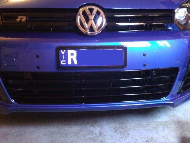

Hey Rob_R, that looks alright! That's about as good as you're going to get without filling and respray, as you said.Originally posted by Rob_R View PostColour coded scrivets (also with full frontal venturesheild fitted):

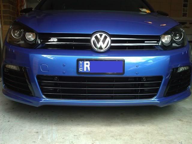

For those who have 6 character "slim line" plates (Euro or otherwise), I still feel the option that AdamD and I went with is the way to go...
From my large installation post (also with full Ventureshield):
And AdamD's car:
