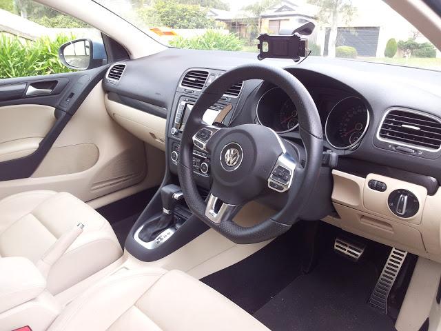

Samsung Galaxy S2. Quick way to charge it up if low on juice (cable is permanently connected to the dock), and the phone goes straight into car mode as soon as I plug it in, with widgets for TuneIn internet radio, Torque app for connecting to the car computer for stats, video recording, etc). Screenshot
Still use the RNS510's many features. Each input source is basically a different playlist/genre of music (SD card, HDD, MDI, bluetooth). Maps are good in my area, voice control working well with the latest maps and firmware when it comes to calling people and entering destinations on the move.
