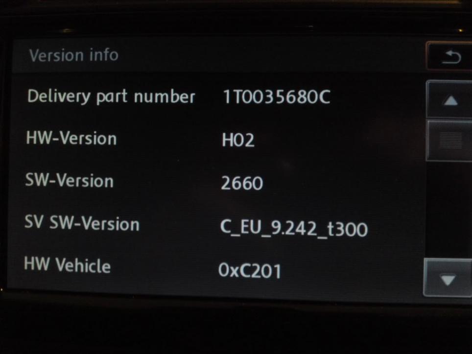

                • #68
                  on some versions, you press the setup button for more than a minute. it will first display the setup menu but continue pressing and it should then display a supplemental menu that shows version info amongst other things.
                  Maverick has a website:
                  alternatively,:
                  RNS-510 (MFD3) Navi System - Discussions about the RNS 510 systems found in the CC, Golf, Golf Plus, Tiguan, Passat, T5, Touran, Touareg and others.
                  mine looks like this:
                  Tig 162 R-Line; Audi TT
                        alternatively,:
                        mr gee - Is that pic from your 118TSI? When was it delivered if you don't mind me asking? Trying to figure out what version RNS-510 the latest Golfs are shipping with, cheers.
                            The pic is off my car but my RNS is not OE delivered but something I picked up off a group buy
