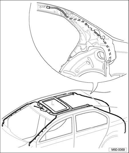

        i did shove some whipper snipper cord down the hole to see if it was blocked but it kept going through. I cant seem to find a drain location that comes out near the door hinge, is it located somewhere else?
          Ok so it seems I gave some mis information. The drain exit is not the same as the MK4.
          They route down the A pillar and terminate under the rain tray.
          You will need to remove the rain tray & possibly the windscreen wipers to get to them
          MKV Sunroof Drain Exit Location?
          MK4 GTI - Sold
          MK5 Jetta Turbo - Sold
            okay so i was able to find the issue. Removing the a pillar i found that the hose that runs along the site goes into another larger hose which exits under the rain tray had come out meaning all the water was coming into my car down
