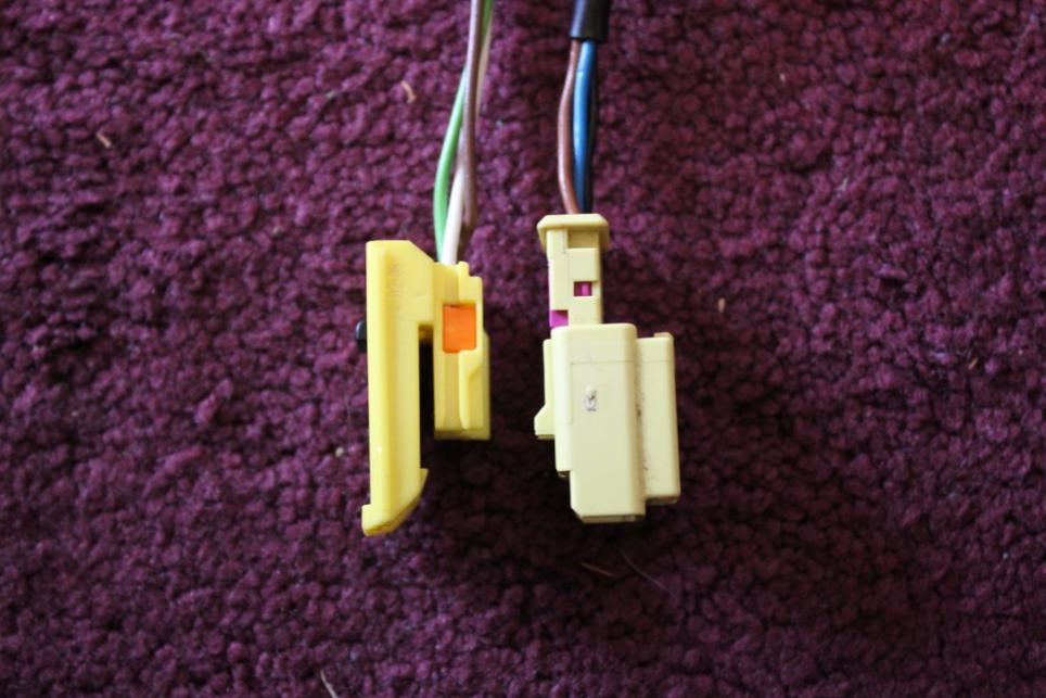

          Thanks asa572. Any chance you have a photo of the old plug? What did you decide to do with the seat in the end?
            the plug on the right (dull yellow) is the airbag plug (seat side)from a 2006 jetta with manual lumbar adjustment.
            the plug on the left (bright yellow) is the airbag plug (body side) from a 2008 golf with electric lumbar support.
            I have some GTI Pirelli seats that I want to fit and I don't want to cut the original seat airbag wires so I'm going to make a patch harness with both the plugs pictured.
