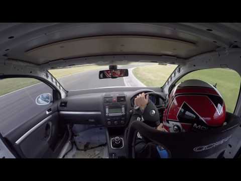

                  Hot Lap Video

                    Yep. New tyres a must!!
                    Your steering looks really light? Have you changed anything there?
                    Current - 2007 Golf GTI, DSG, RCD510, K&N Panel Filter, BSH PCV revamp, Bluefin Stage 1 tune, 18" Omanyt's with RE003s.
                    Previous - 2003 Renault Clio Sport 172 - Flame Red. -Gone-
                      We will have to run a control Hankook semi slick tyre, this was just an initial mechanical shakedown to see if there were any underlying issues with the car we bought. No point wearing out race tyres on that.
                      Nothing done to the steering, just the Coilovers installed with a bit of camber which would have chang d the geometry a bit.
