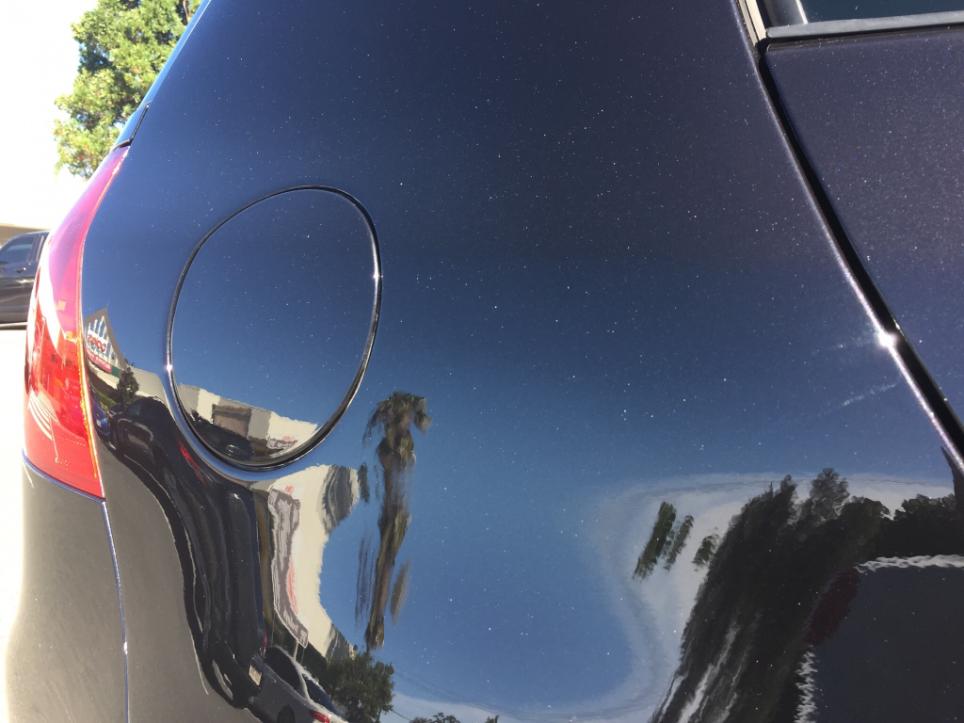

A pea-sized pint bubble appeared under the paint, I noticed it for the first time after washing the car. It was small and firm initially but appears to have softened and grown over the past few days. Anyone else experienced this and whats my best course of action to remove or at least prevent getting any larger? Or will it continue to get larger if untreated?
Pea sized bubble has appeared under paint after a wash?

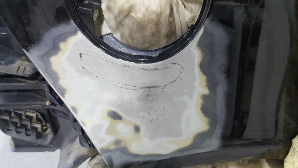

The repairer said he'd never seen rust on a Golf in this area before either, and from his initial look did have a very wild guess that previous bodywork may be the cause, but he said he wasn't really sure. I'll pick his brain when I collect the car and post any more updates.
The car's been in the family since 2011 with no issue so if that's the case it's been bubbling under the surface for a long time. hopefully your feedback means this is an isolated incident and i don't have to worry about any further rust.
For anyone wondering, cost is $670. The fact that the repairer comes highly recommended doesn't make this any less painful on a 10 year old car.2010 MK6 2.0 TDI Golf Comfortline w/ Sport Pack *SOLD*<br>

Well I've had it back and am very pleased and relieved with the result. Can't comment on the warranty issue and by the sounds of the diagnosis I wouldn't have been covered I imagine. Apparently the drain in the fuel filler cavity was no longer connected to the tube that drains to the rear of the wheel well.
Behind the rust patch in between the skin and the steel body of the car there was a 'sealed' cavity that was holding the water no longer being drained apparently which explains the rapid deterioration of the skin. He said it was like tin foil.

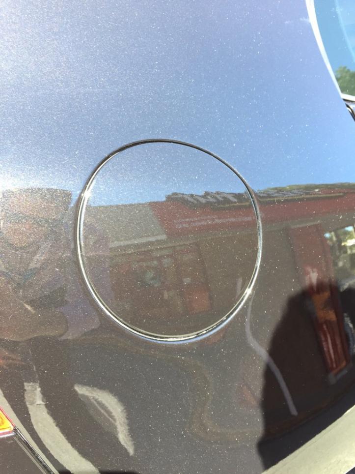

Photos don't do the job justice. It looks seamless and better than I could have hoped.
