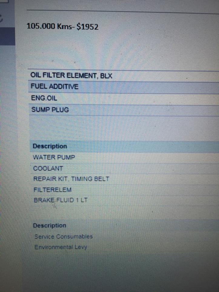

    Need some help. Just got quoted $1900 for the 105k service of the above car. Is it worth it?

    Need some help. Just got quoted $1900 for the 105k service of the above car. I think they change the timing belts and some other big stuff. Is it worth it?

      You really need to state what that includes - for example, that's about $500 overpriced if you're only due oil, filter and timing belt kit. However if that includes brake fluid, pollen filter and water pump then I'd say it's about spot on. It's the most expensive service you'll have to do and if you're DSG then the 120k isn't much better.

          It was quoted by VW dealership in castle hill @$1950 as per pic. Anybody you know who can do it cheaper the same stuff who is reliable and good? The car is real good cons. Have had no other issues since new. I'm on the north side of the bridge. Thanks for any help.

                    Yeah - timing belt services are every 7 years or 105k (whichever is first) so you tick both boxes.
                    If you take brake fluid out that's ~$150 - but you may be due it (every 2 Years as per VW/Audi Service Schedule)
                    You might as well do the water pump, but if not, they will inspect it for seizing, leaks etc. If you opt not to do the water pump then that's about another $350 off.

                      I would strongly recommend doing the pump. They seem to be very prone to bearing failure on these engines. In the examples I've seen, they were very lucky not to throw the belt and junk the cylinder head. And these happened well before the belt was due.
                      But not doing it won't save you $350. They're only $150, and about 2 minutes to swap over once the belt's off.
