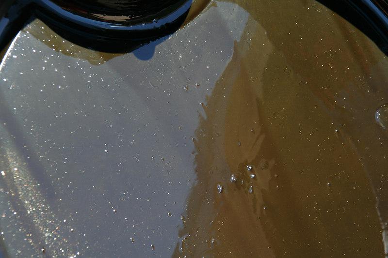

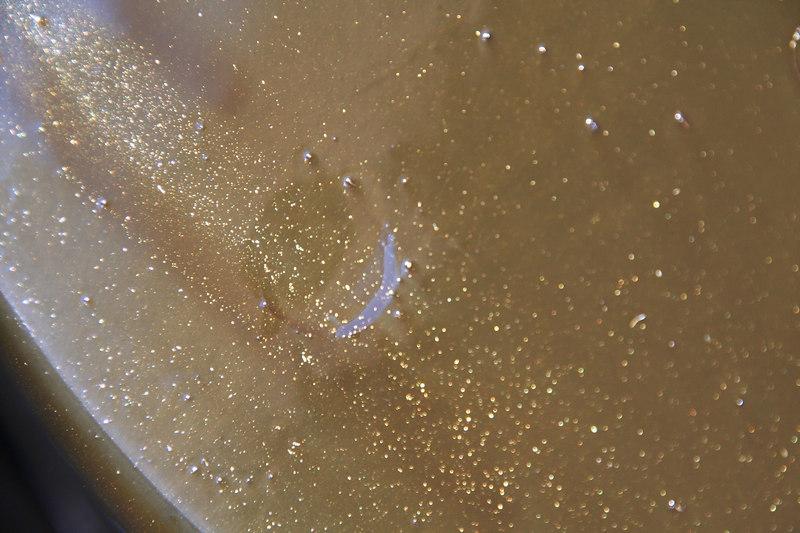

                              i changed my oil myself at 7,500km and there were no metal particals to the naked eye.
                              Engine was noticeably smoother after the change though.
                              For me it was different to your first point (see below from change at 6200kms) and the same as per your second point. Much smoother.
                              I've changed the oil twice now at mid interval. Can't hurt and is kinda fun to get your hands dirty.
                              More HERE.

                                i changed my oil and filter too last weekend, the car had done 6500km in about 6 months ( yeah i know it's not much... it's the weekend fun mobile for me). The wife does numerous short trips every week (about 5km each hence the need for the oil change). The oil was dark brown which i suspected but the oil filter was charcoal black!
                                In hindsight i should have kept the filter and taken shots of it. Is this normal colour change for a filter that is 6 months old??? i knows it's supposed to filter the oil but how bad can oil get in 6 months. i'm curious because i'm wondering if the dealer even changed it last service, i know for sure they charged me for it though.
                                Can anyone shed some light on this?
                                Thanks
