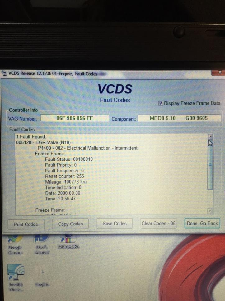

            Ran a scan last night and found this fault.
            However all I can find online about fixing the egr valve is for Diesel engines... Does the fsi engine have one? And if so where is it located?
