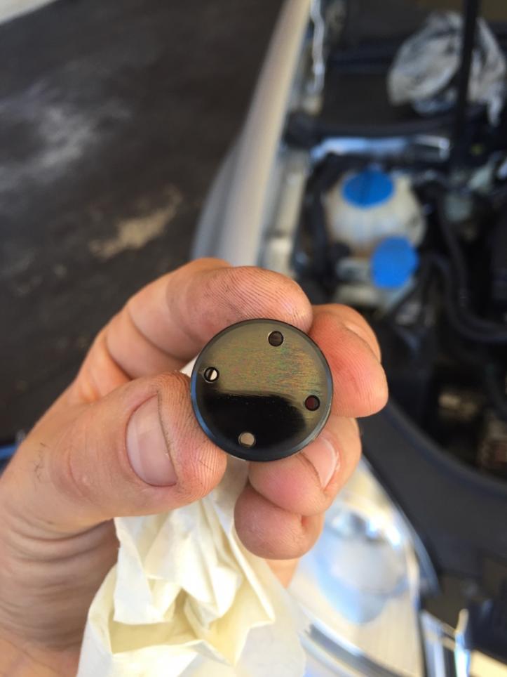

    I have checked that cam follower its all good and also checked for fuel leaks and saw nothing. I'm thinking low fuel pressure sensor malfunction?

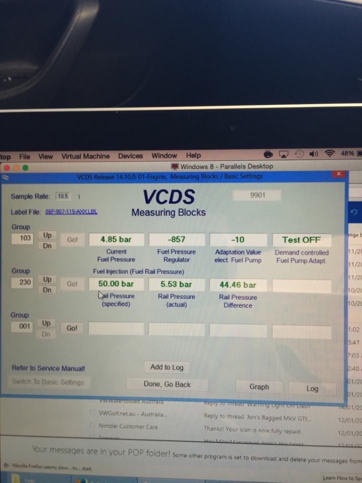

                I couldn't check fuel pressure while idle. So I tested with accessories on if this pic helps

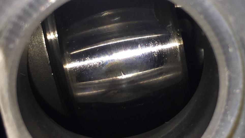

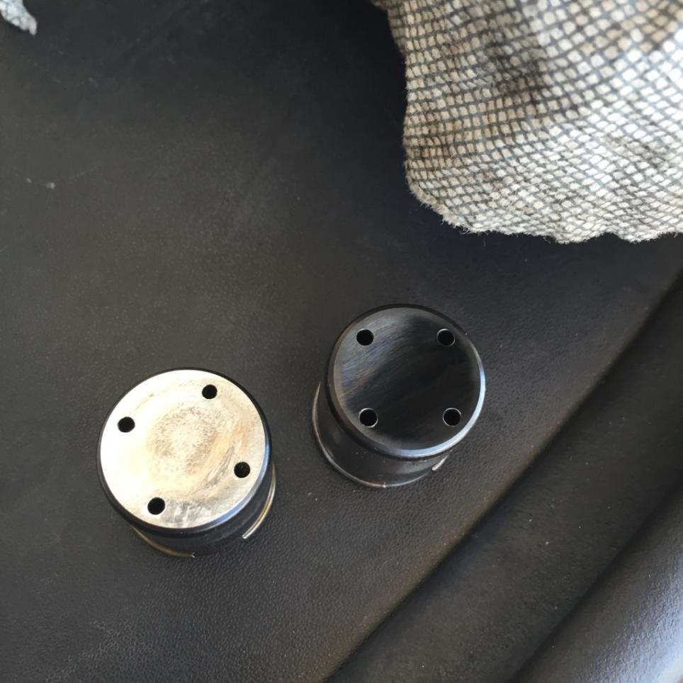

                    Thanks Guile if it's 2 weeks and I haven't got this sorted I will get that sensor off you. I have had a filter change and a rs4 fuel pressure regulator valve 10k ago, and I did check the cam follower and its looked in perfect condition just oil smudge marks from wiping oil of It.also have pics of cam lobe in cylinder head
                    My previous cam from 10k ago on the left and the current one on the right

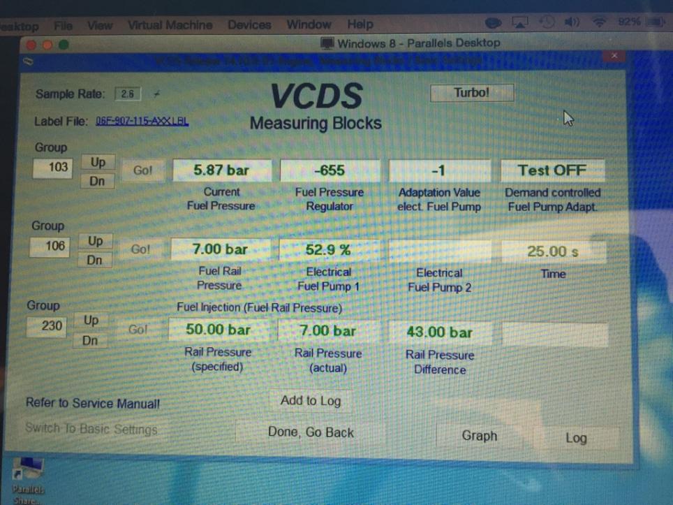

                            Okay so I managed to get the car to start and got it to operating temp, went to measuring blocks (pics below.)
                            And also got a multimeter to the fuel pump fuse and it was drawing 2.7 amps

                              So your H pressure rail is 43 bar under spec...you need a mechanic guage in the H pressure line to see if it is actually low or if the sensor is reading incorrect...
